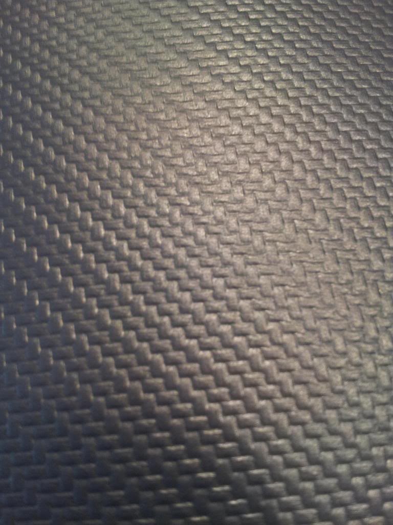

Here is my HX seat I wrapped with vinyl that LOOKS like carbon fiber. This was the first seat I have ever covered. I got the material from www.yourautotrim.com
http://www.yourautotrim.com/shcafi.html
Having problems posting so if this comes as a double, my apologies. Your seat came out awesome, the price is definitely in my range, but can it be stretched over a hump without leaving a hump or stretched to far on the hump making it thin in spots and bunched up in other areas. I am covering a 96 gti touring seat. thanks
Thanks for the reply. I did look at that site still not sure of which direction to go in. Another responder directed me to a site that has great results as far as his seat, but may not accomodate mine and it is a stretch seat rather than fitted to my gti hump.
I was more or less just giving you what the CF looked like in vinyl. There are a few companies that already make fitted covers for seats and that is usually the safer option, especially for seats with many contours. I have a few hours just into that seat alone. Hydro turf makes seat covers as well as black tip.
