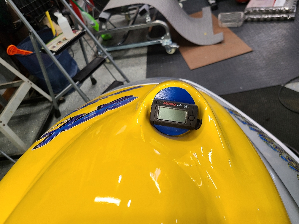

Front or back? I would glass a spot in for it.

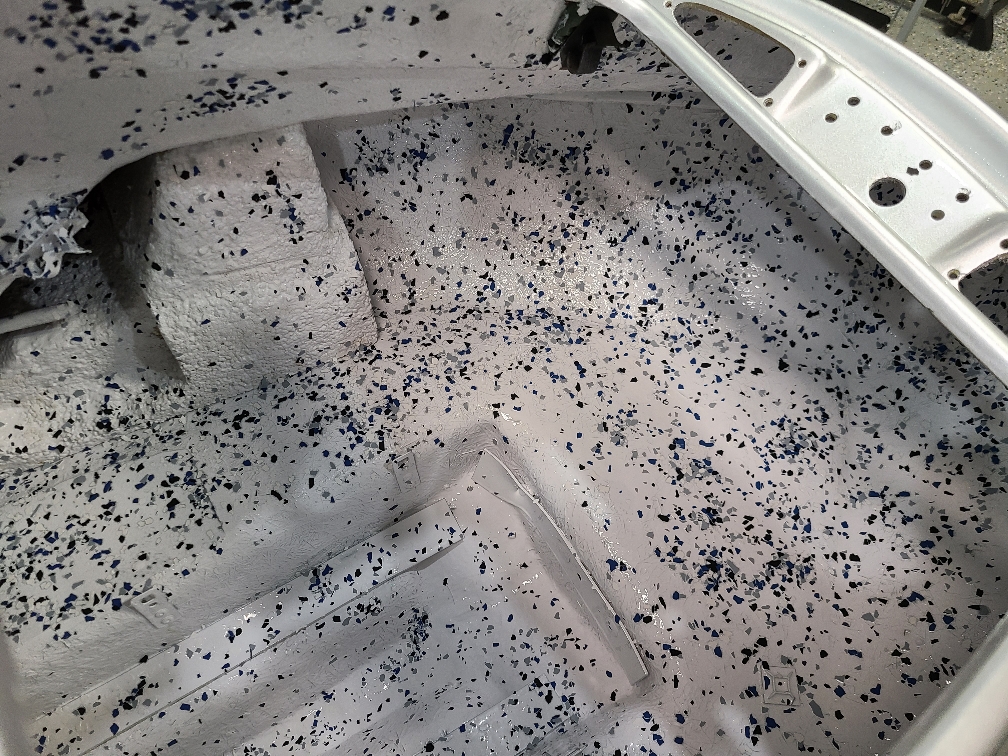

Getting some more work done to night....slow but trying to stay at it. Had to do some cutting to get the pipe in . Ill test fit it in the morning....

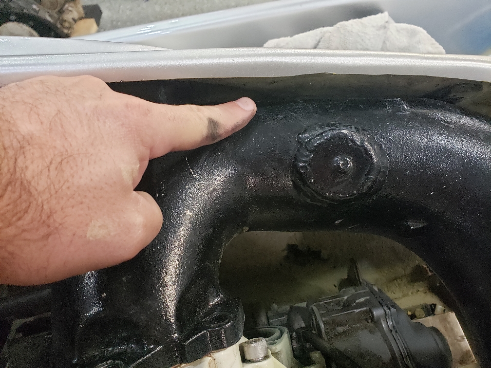

Well got the pipe hitting on one side. Im working on getting the engine perfectly aligned now and see what I need to trim and damn this sucks!

As much work as you have done might as well have moved the exhaust outlet to the other side. Didn't you paint the bottom of the hull ?
