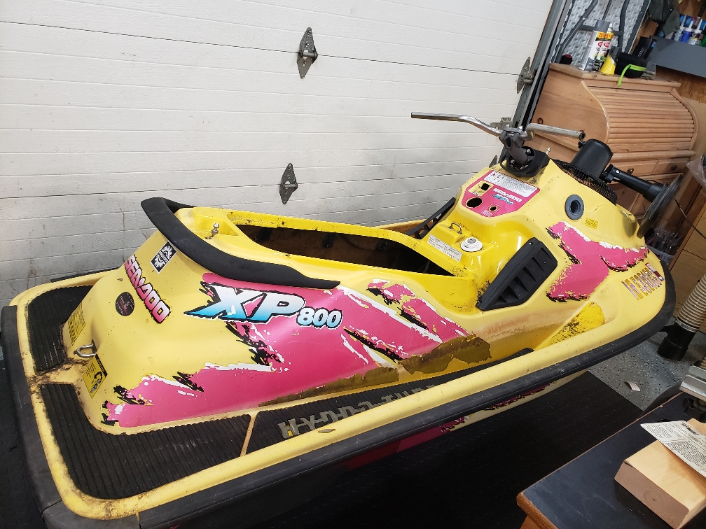

Hey guys, its time to start this. I'm going to build a seadoo 951 x4 this winter. Still need a few things.
Need: umi, drop trim or hx trim, ada head or a good head.
Im going to run a white pipe.
Going to start with a 96xp. I will be doing the ski from top to bottom and you all know I love to paint.
Any thing you guys want to see? I plan to glass in the motor mount.
More to come. Im about 2 weeks out from going full bore on this.

Going to start with a xp800. From what I have seen this is about 30 lbs lighter.

Yes good choice. Thinner top deck and a different glass or production technique then the 96xp has from what I understand. Shame to lose the original look of one of those but you’ll be adding value to it overall.
