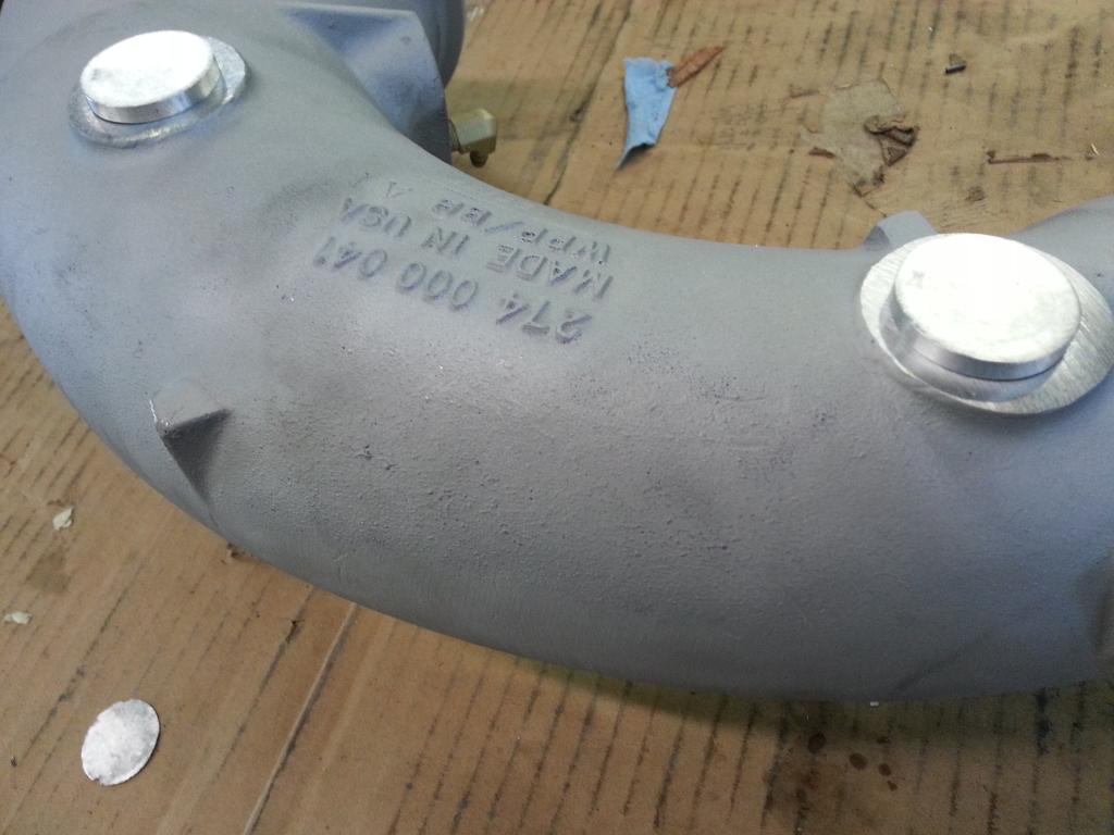

I wonder if you use good high temp RTV sealer on surfaces of brass washer. It would it work? It's a low pressure / low temp area at that end. It's already cooled by the water injection. Mate it up to where it came off. So it fits back into the grooves and such where it came off. Thin coat of sealer you saved $50.

Your supposed to use orange hi temp rtv, they come that way from the factory, but you still have to have the washer. It's on the microfiche.

I contacted racerxxx last monday about these welch plugs and he said he was all out and would have to make more. Well he made more and I got them today in only one week (pretty fast/reasonable to produce some and send some to me). I highly recommended these quality plugs for repairing the common leaking head pipe plugs on our 'doos and Dan is a good guy to deal with. Thanks!

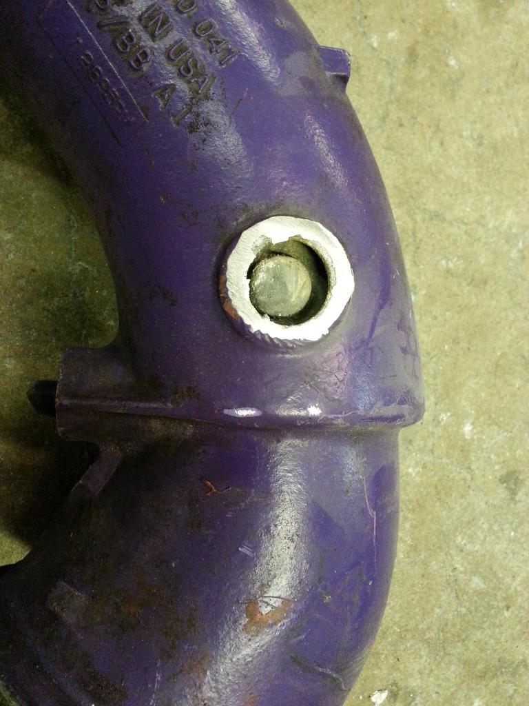

I understand the exhaust and the plugs are both aluminum. Around here they are charging about $100hr (going rate) to weld Aluminum due to the cost of the gas to weld it. I only need 1, but figured I get a couple. I have a mig welder..but I can only weld steel from what I understand about my setup.
Question...what if I sealed the plug on with JB Weld all around the plug? How long you think it would last?
Edit: just found this "Alumaloy". No need for a welder now. I'm passing on the jb weld and getting Alumloy.
