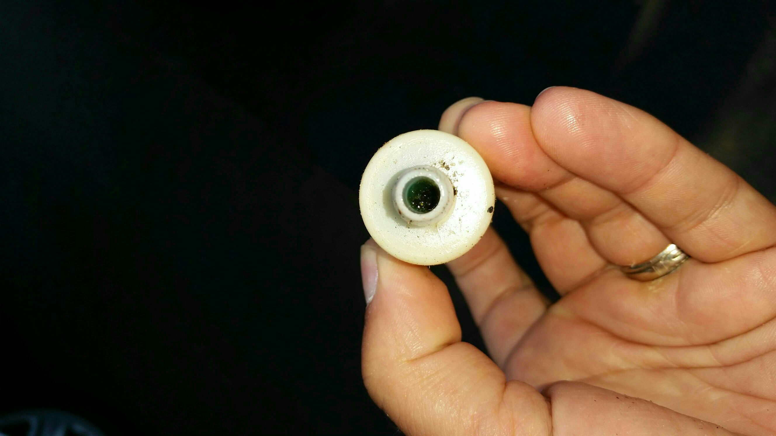

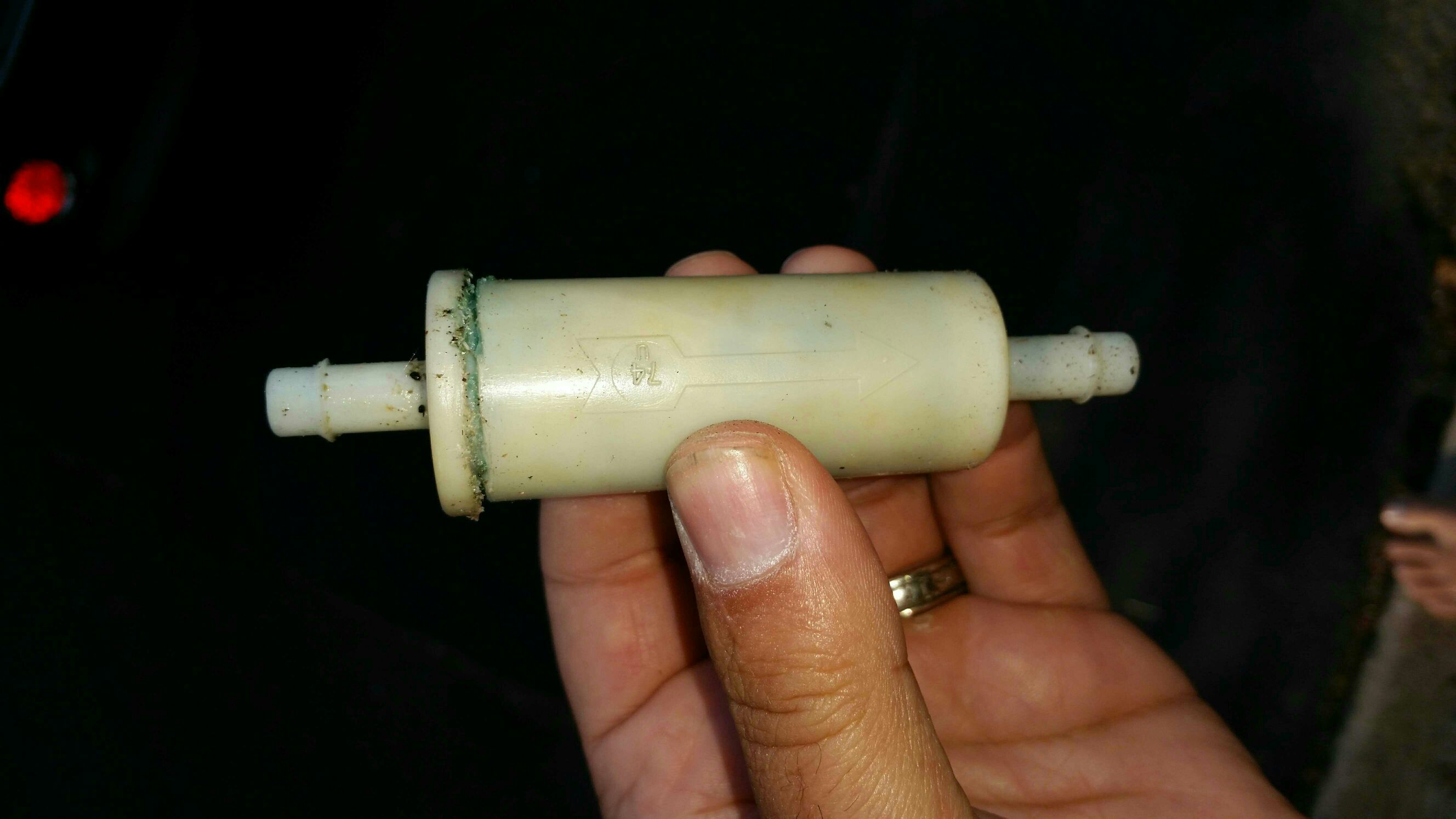

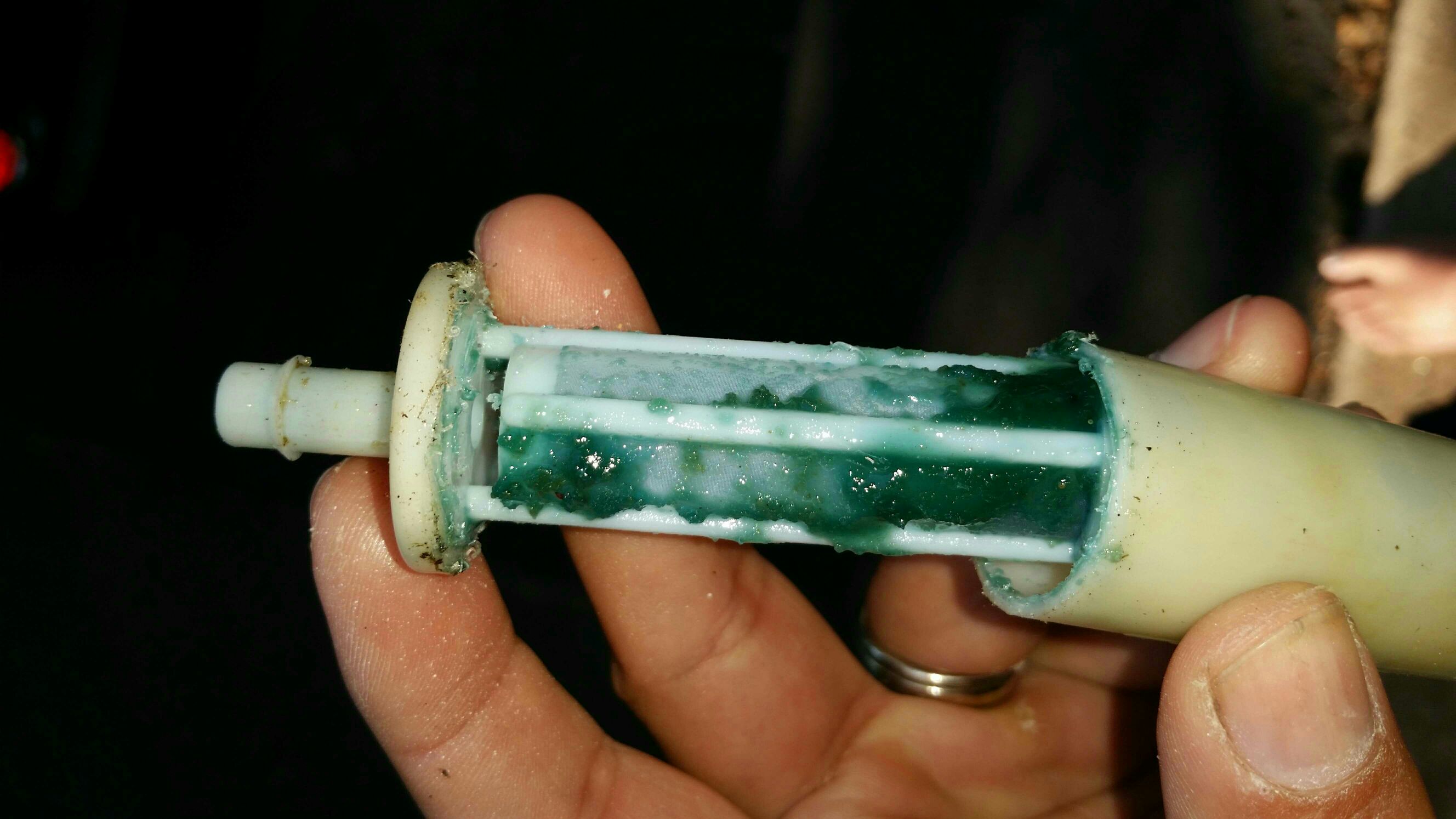

I just found the original oil filter from when I purchased my Challenger. When I bought it, it was filled with the green-blue oil which I am guessing was TCW-3. Out of curiosity, I cut it open to see what the insides looked like:
The nipple was completely clogged and the oil had gelled inside the filter, clogging most of the screen.
New owners of old boats/skis; save yourself some headaches and replace parts like this for a few $, especially if the previous owner used the wrong products or you don't have the history.

Almost like those of us that keep arguing to only use the correct oil know what we are talking about.
