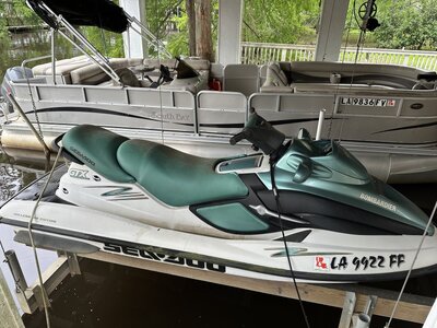

some dear friends of mine gave me and my son a 2000 Sea Doo GTX Millennium edition ski.& trailer. Last ski I owned was a 2004 Yamaha XT1200. The ski was stored on a lift under a roof nut not covered. They are older and their memory is not the greatest. They are not very mechanically inclined so Im not sure of the maintance history.
According to them they ski has not been used in 1.5 to 2 years. Im sure it was never winterized . On the outside the ski is intact with everything there. It just needs a good cleaning. Seats are in good shape with minimal fading on no cracking. Obviously the battery is dead. All he could remember is the ski not starting a long time ago but could not recall if it was just battery or not firing. I am fairly mechanically inclined as I do all my own work on motorcycles. My limit would be tearing down an engine. I am a certified youtube mechanic HaHaHa So after getting it home and taking the seats off nothing obvious jumped out at me. Everything appears to be there with no shadetree modifications. biggest worry from the jump is that if it were never winterized could it have a cracked block? . We live in the deep south but did have a couple of deep freeze days over the winter. there is a small amount of oily looking sludge in the bilge along with some dirt dopper nests under the seat. My son is 19 and this will be a project for the both of us. I have a 22ft chaparral that is our main watercraft, so this will be a toy to use with it. I look forward to getting a lot of help and suggestions from you all. It will be a few days before I can start on it, but here is my plan of attack

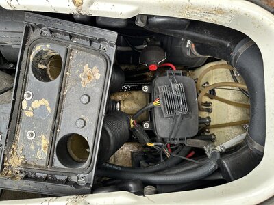

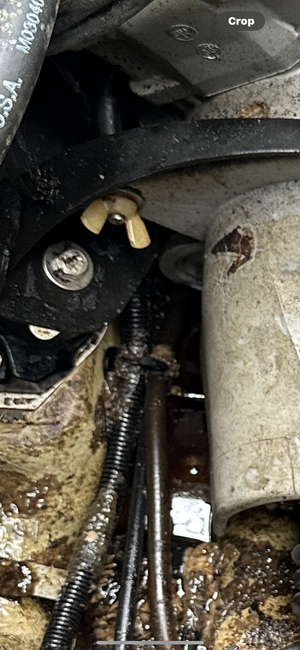

what is that small screen in the second pic?
Is there just a screen and not an air filter in the intake?

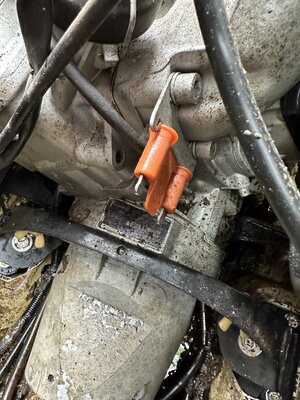

also those orange prongs are those ground blocks for jumping?

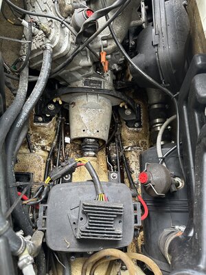

what would you suggest to use and how should I clean the bilge out.
Ive watched a ton of youtube videos and am getting an idea of things to check. so make suggestions

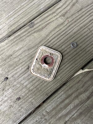

I pulled the plugs ( see pic)
I ran a ziptie down each cylinder and best I can tell there is no water or oil in there
I sprayed PB blaster in each cylinder to soak

Thanks. I believe I’m the third owner . I know I need a battery and plugs . Don’t know much about its service history. What is that small screen in the second picture? What filters etc should I change .

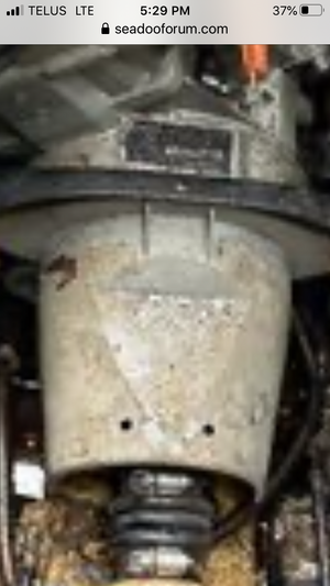

309AC320-625C-497E-A24F-A5DA0C82A432.pngPTO flywheel is right under this cover, I don’t know what that is in your second picture. Don’t recall ever seeing anything like that in any Seadoo I’ve owned. You should change out or I will get slack for this clean out the old oil filter with simple green ordish soap and dry it out thoroughly, it’s only a screen inside of it. If you go to seadoowarehouse.com you can pick your machine there and then there’s parts fiche for everything on your machine. Probably a good idea to clean the micro filters in the carburetors, is that carbureted? Dual carb? If it’s dual carb there will be a micro filter in each carb. And clean the rave valves, cleanjng tjose should be annual maintenance and who knows when t he last time it was done. I know I’m supposed to and I don’t do it every year myself.

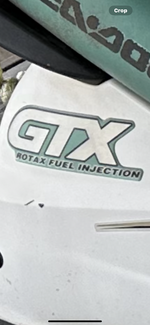

Is this not fuel injected ? And would taking these wing nuts off expose the flywheel ?

Yes, it is fuel injected and oil injected.

The orange lugs ae for grounding the sparkplug wires when cranking it over without the sparkplugs in.
Yes, rear PTO (Flywheel) is under the gray cover with the wing-nuts.

Yes, taking those wing nuts off will expose the flywheel. Ok, so that’s fuel injected, not carbureted. Forget about the micro filters in the carbs of course. I have a 99 GSXRFI but I have never really worked it, only on carbureted skis but I have a or led on fuel injected snowmobiles. Another common thing that is done when a machine has sat for an extended period of time is to change the fuel selector valve, this is the valve that turns your fuel from ON OFF and RESERVE. To be honest, there’s no sense going through everything that could be wrong with it till you try it, If it mine, I would drain that oil as I mentioned, try to get it all out, take the oil tank off and clean it out good, clean or replace the oil filter, take the oil line off the rotary valve cavity and try to drain as mich oil from it and the lines as you can, fill the tank back up with oil, make sure you get all the air out of the oil filter, bleed the oil pump, check that the marks on the oil pump lever are lining up with the mark on the oil pump housing. Drain and refill the gas ad you mentioned and give it a try. Everything else I mentioned still holds, if it runs crappy don’t keep driving it, it won’t fix itself, only destroy itself if it’s not running right. Don’t run it out of the water. Etc. And see how it goes, might just be fine as is.
The thing in the second picture is the voltage regulator Rectifier. Also I don't think there is a fuel switch could be wrong though.
HaHa, not sure why but I thought the second picture was of that thing that looks something like a vacuum filter or something

Prob was not a good idea to take pics after I removed the center support and battery. I did that just to try to get a more complete pic of what I was working with. I want to spend the minimum I have to so as to see if this is a viable ski. If the engine is not seized or has internal damage I will start replacing vital components and clean it up real nice. Can I use a pressure washer with a low force tip to clean the engine compartment?

so attach the spark plug caps to the orange posts on the engine when turning it over
