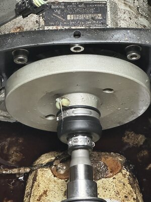

I’m not sure which way the engine rotates when it’s running but I always rotate them clockwise from the back, it doesn’t matter though , you can rotate it clockwise or counterclockwise by hand, your just checking to see if anything is seized up
Thanks
First bit of good news !!
Engine turns over by hand
👍, now with the spark plug boots grounded to the orange grounding pins and the spark plugs out see if it will crank over by pressing the start button. Take notice if anything blows out the spark plug holes while cranking it over

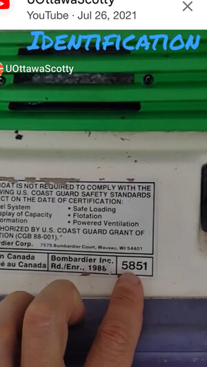

Yea, I’m gonna pull the pump tomorrow and see what I have. See a couple of used ones around $200. I see model numbers on the fixh that start like 5608 etc. how do I tell what I have ?
You can look around for a sticker similar to this one for your model number but I wouldn’t worry to much about it, they all seem to have like 3 or 4 different model numbers for the same machine. As long as you are looking at parts for 2000 GTX RFI, you will be fine. If you find a used one off of a different year or model just cross reference and check the part number for that year

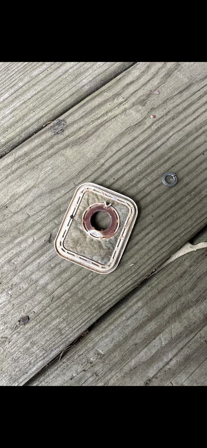

Somebody has been in this pump before . Found this in one of the compartments. I believe this is one of the filters that goes on the fuel pump
