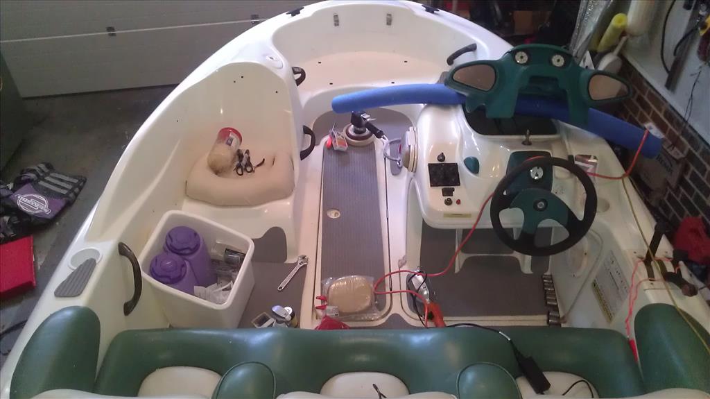

I spent a couple of hours Friday and Saturday and most of the day Sunday in the garage working on the Challenger. Really happy with what I got done, but also frustrated that EVERYTHING seems to be taking about 2-4x as long as I thought it would. I guess I just work really slow.
Here is what I got done:
-registered the boat with the state so I'm legal to use it... and the added bonus is that my county can start taxing me every year just because I own it. Also ID'd an option for the rub rail insert... but not liking the $150 price.

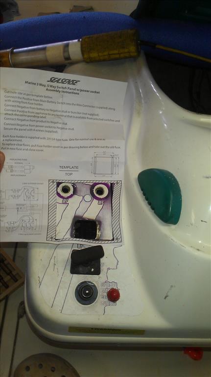

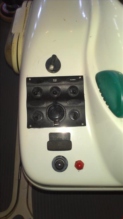

-installed a 5 switch + 12V socket panel at the helm. http://www.amazon.com/gp/product/B003E24MKA So far, I've just hooked up the 12V socket (so I can charge my mobile phone), bilge pump & blower. Might get an on-off-on switch and move the nav-off-anchor lights to the panel and plug the hole that rotary switch sits in. I'll be adding LED interior and transom lighting at some point. When I looked at adding a 12V socket & 2 other switches, it looked like a simpler, cleaner solution to go with the panel.
Before:
In progress:
AHHHH! Don't cut me, bro!
Done:

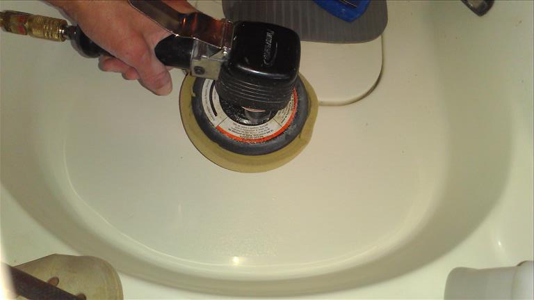

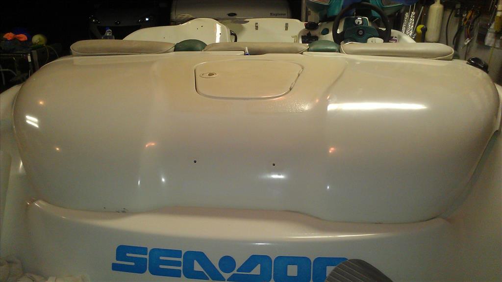

-compounded, polished & waxed the upper exterior gel and a bit of the interior. Used the Meguiar's Marine/RV Fiberglass Restoration System kit and am VERY pleased with the results. However, not as pleased with the Meguiar's 6.5-Inch Foam Pads (Cutting, Polishing, & Finishing), as the velcro backing came off of the cutting and polishing pads before I even finished the above the rub rail exterior section on my little boat. Definitely complaining to Amazon/Meguiar's on this one, as they should hold up better than that. The pads worked great, just didn't hold up.
Not a great shot, but the left has been polished, not the right:

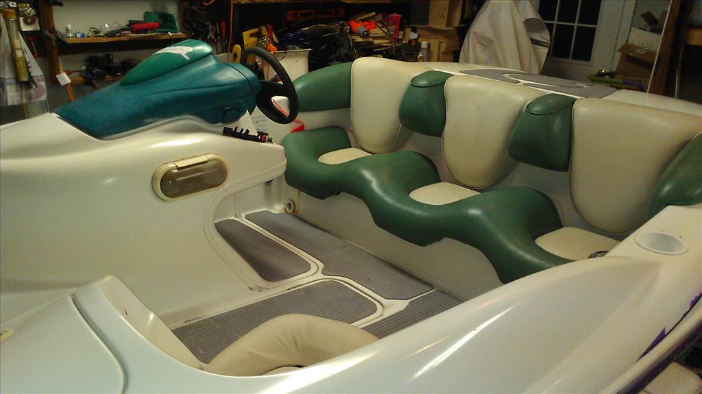

-reinstalled the engine cover. Sadly. I did this very late and the kids were already in bed, so I couldn't run the air compressor to power my buffer. So it still looks chalky and nasty. Probably just as well that it was late, since my cutting and polishing pads wouldn't attach to the buffer any more anyway. :(
-made temporary covers for the 2 parts of the spotter seat that are visible. I'll get a kit from Kieth at http://seadooupholstery.com/ once my budget has recovered from all the work thus far.... so I didn't spend much time and just used some scrap vinyl. Intended as a short term solution so the seat is at least usable. Screwing the seat base down to the floor of the boat was the hardest part, as those screw holes are HARD to reach. I ended up pulling several long slivers of fiberglass out of my arms before I was done.

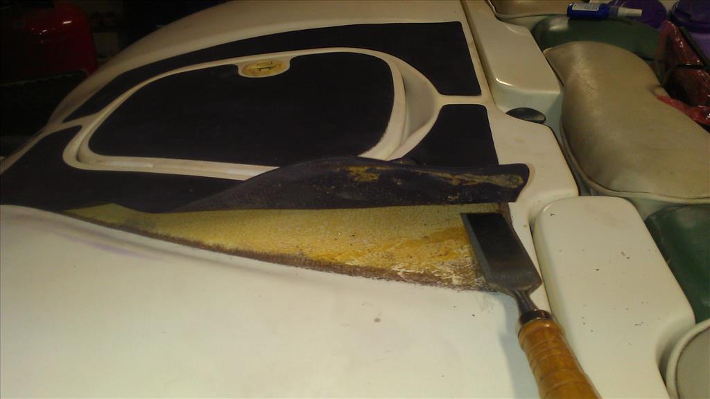

-used a sharp wood chisel to remove some more of the oh-so-stylish purple and pink graphics sticker from the starboard side above the rub rail. So far, this seems to be the easiest method, although it is way easier on flat areas where the blade can sit flat on the hull vs curved areas.

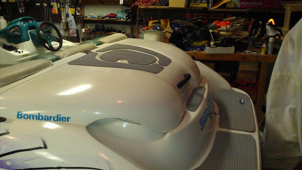

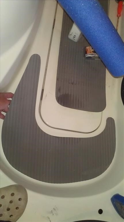

-pulled off the last of the factory traction mats from the engine cover. The swim platform mats were hard and disintegrated when i tried to pull the off. these mats pulled off in one piece. :)
-Used the wood chisel to remove more of the traction mat glue from the swim platform and engine cover. The hard, crusty glue came off pretty well with the chisel, but the sticky glue didn't want to. I found that if I soaked the sticky glue with acetone, then scraped it with the chisel, that worked best. It doesn't get all of the glue, but gets most of it. I think I've accepted that I won't ever get all of the glue off and am just tying to get enough off that I can put the new traction mats on without fear that the old glue underneath will come loose.
-Booya! As I was typing this note the FedEx truck dropped off my new BlackTip mats. :) I unrolled them on the boat at lunch and put stuff on them to help them flatten out. Maybe I can install them tonight.
You can see the difference in the polished and waxed part, and the unpolished engine cover:
One problem... the new mats don't completely cover all of the nasty old glue on the swim platform. Looks like I'll have to work harder to get all of that residue off. Grrrrr. :(

I'm thinking I may have to sand the hard glue residue, as goo gone and acetone aren't softening it at all.

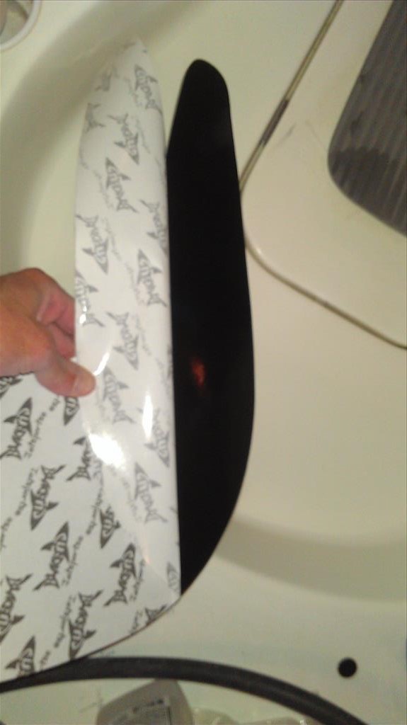

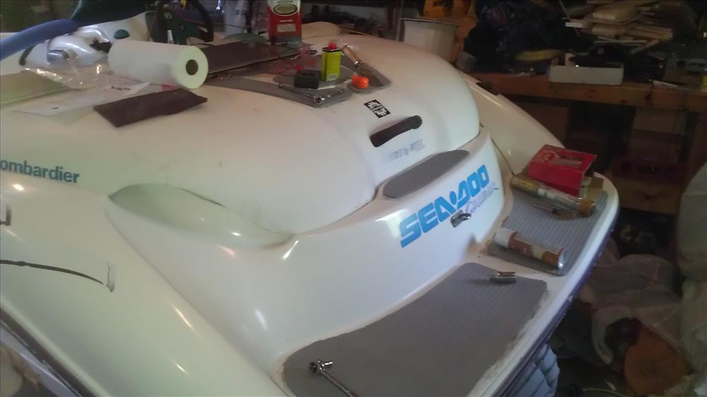

Prepped the boat and installed the first couple of traction mat pieces this morning. Also had to call SBT because one of the pieces of traction mat was missing. They are going to cut it and send it to me this week as they don't keep any pieces in stock. Sadly, the kit does not include pieces for the top of the gunwale by the port cup holder, or on the bow... both places that appear obvious to me that they should be there. The only option is to buy a full 39" x 78" sheet for $46 + almost $20 for freight. I probably need about 1.5 square feet of mat to fill in these places and don't care to spend over $65 for those 2 pieces. It sucks that they won't sell anything smaller. I guess I'll just have to keep an eye out for eBay or classified posts for partial sheets of slate gray mat.
And I'm returning the Meguiar's 6.5-Inch Foam Pads today since the velcro backing already came off of the cutting pad, and is half-way off of the polishing pad. Both were only used to do most of the topside of the little jet boat before they started coming apart. I've used the a different brand of cutting pad to do most of the topside of my other boat (36 foot cabin cruiser with a LOT of topside fiberglass)...so probably 5 times as much use, at it is still going strong. Really not happy about this, as I need the pads to prep the areas that the traction mats will stick to. You can see in the first pic below where the polishing pad has torn loose from over 1/2 of the velcro backing.

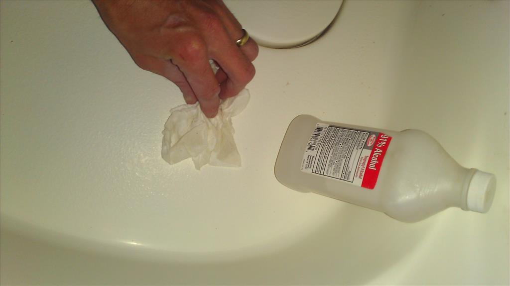

Surface prep:
Compound and polish...
Clean with alcohol:
Test fit:

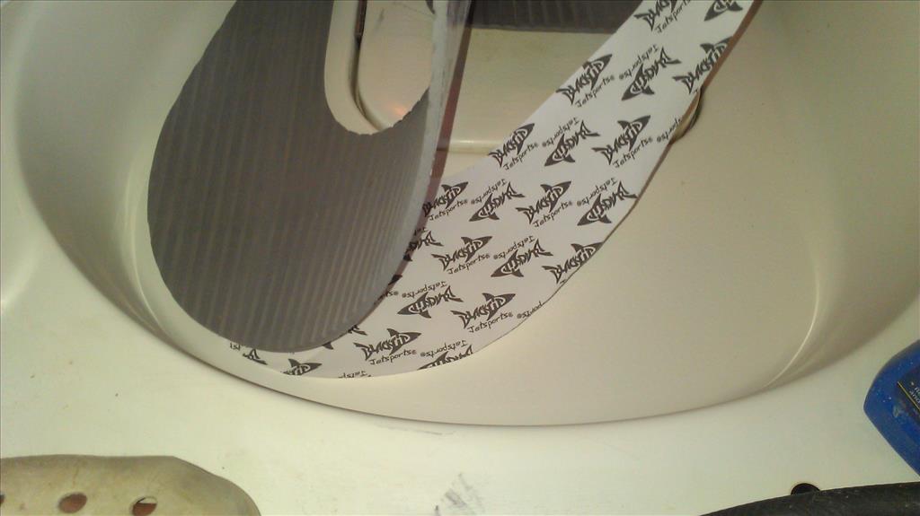

Applied the mat starting with one side to get it lined up, then peeling back the paper backing as it progressed:

cleaning glue, rub marks, stains. ACETONE works great for removing any left over residue from glue and rubs marks in the hull... do a little at a time. I also use Goo Gone for lighter uses.
cleaner: Marine Spray 9 is awesome for mold removal. and daily care of washing the boat removing the day`s stains. I also use Meguires Gel boat wash...
Good to know. I've been using Acetone and Goo Gone on the old traction mat glue. Had to stop until I can get the boat outside. I ruined too many brain cells in undergrad... can't afford to use that type of solvents in the garage and sacrifice any more brain cells. :)

My to-do list on the Challenger is actually getting shorter. I fully expect a few things to break on the next trip out, since Murphy likes a long to-do list. :rolleyes:
Worked late the past 2 nights and for an hour before work each day and knocked out a few more tasks.
-It was warm yesterday so I opened the garage doors to get good air flow and busted out the acetone, goo gone, scotchbrite pad and wood chisels. It took an hour to get all of the old traction mat glue off of the engine cover and swim platform, but I stuck with it.
-My 8 year old really wanted to help, so as soon as the acetone was put away she helped me compound, polish and wax the remaining topside areas. I was nervous about letting her use the pneumatic buffer, she was SUPER careful and really enjoyed helping.
I think it turned out well :thumbsup:
Then we wiped down the spots where the BlackTip mats would go with alcohol and started installing the mats. No joke, the PSA on these mats is incredible. Better line them up just right the first time, 'cuz they aint coming up.
Since I had a LOT of surface prep to do before putting the mats down, it took several hours to install them. If my gel coat had not required so much attention to prep it, then I think I could have easily installed the entire interior and exterior traction mat kit in 45 minutes or less.
We did all of the topside compounding and polishing last night, but I still had a little waxing to do. Knocked that out this morning. Also reinstalled interior grab handles (after armorall'ing them), reattached the bow seat back and the port gunwale plastic step tread that the PO had installed. I really wanted to replace this with Blacktip traction mat, but there wasn't a piece in the kit for that location.
I also drained about 12 gallons of gas from the Challenger, leaving less than 1/2 tank. Filled up the riding mower, put 5 gal in the E150 van (it had about 20 gal of gas in it already, so it should be diluted enough), and left a full 1 and 2.5 gal gas can in the garage for a friend's weed eater and mower.
Now I can dilute the old gas with fresh gas on the next trip. :)

WOW!!! :thumbsup::thumbsup::thumbsup:
That really looks Amazing and came out really well!!! If I had lived closer I would have traded wrenching for detailing...lol...
Looks really Good! congrats!:cheers:

Oh, also... I sent back the crappy Meguire's 6.5" cutting and polishing foam pads and replaced with pads from Chemical Guys. So far, the new ones are working fantastic and look like they will hold up MUCH better.

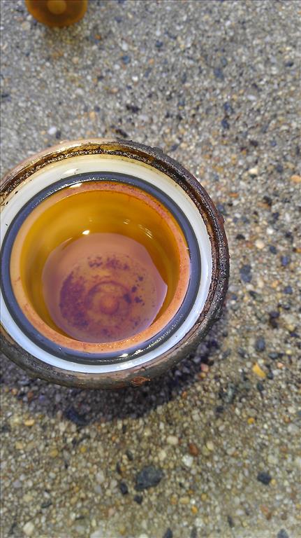

And I FINALLY got the fuel filter out (it was stuck and I was afraid to really crank on it before). I used I big set of slip joint pliers to grab the fins on the sides of the filter housing and gently squeezed while using the leverage of the long pliers to get it loose. After I got it off I saw that the bottom of the housing has a plastic square protrusion that I could have put a wrench on to get the housing off. Doh!
I am really embarrassed that the fuel filter kept slipping my mind and I had not gotten it apart until today.:facepalm:
It was pretty gross!
Element:
Element:
Housing:
I cleaned the stock filter and element before reinstalling, but honestly, that little screen can't be doing much to filter the fuel, and certainly isn't separating out any water. I see that PR went with industrial strength Racor fuel filters. I was thinking of one of these http://www.amazon.com/Seasense-Fuel-Filter-Clear-Aluminum/dp/B004XAEW6Q/ref=pd_ybh_10, as I really like clear water separator bowl.
I had big Racors on my first big boat which I had trucked from Maryland to NC. The trip shook up a few decades of stuff that had settled in the gas tanks and within 5 minutes of starting the engines both Racors were completely clogged. They did their job, but I couldn't find local replacements, and when I found them online they were really pricey. So I went with spin on filters from Walmart, as they were affordable and getting replacements was cheap and easy. However, they had no water drain, which still seems odd to me.
Fuel filter suggestions anyone? Keep the cleaned stock filter element, install a new stock filter element upgrade to a water separating filter, something else? I should note that I am WAY over budget on this project, so I'm getting more price sensitive.
And seeing how bad the filter was makes me even more embarrassed that I've been avoiding rebuilding the carbs. Got to be sure that gets done very soon.
I suppose I also need to pull the fuel pickup from the gas tank and see if there is any debris in the bottom of the tank that needs sucked out before it clogs the fuel system.

ok, first thing is you can`t technically use a plastic cup Fuel/water separator. That`s why the all aluminum ones are a bit more money. the ones with the plastic drain cups or sight cups are for outboards and above deck. The all metal housing are for inboards/below deck as in our boats...
choices, you can use a generic 5/16 metal housing automotive filter for around 5-8 bux. I don`t really like the thin plastic ones like Moeller or Fram etc. The one you have I think can be ordered or bought locally at the stealership. just get a new O ring as well...
battery charger> don`t cheap out here.
Battery tender Jr > http://www.batterymart.com/p-batter..._Code=atv-jet-ski-motorcycle-battery-chargers
these come with a lead to attach to the battery terminals that you leave on, and just plug in when you need to maintain the battery. also these low amp units are MPEM safe... whatever you do, don`t use a high amp automotive charger with the battery cables connected or the MPEM goes Poof...
I have the Tender Jr and it works very well...
after seeing that filter, I`ll bet theres some crap in the carbs for sure, if not the body the little filters in the carbs for sure...
Hmmm. Interesting that the stock SeaDoo filter housing is plastic.
I'll have to think more about options here, and see how it does with the cleaned stock filter.
