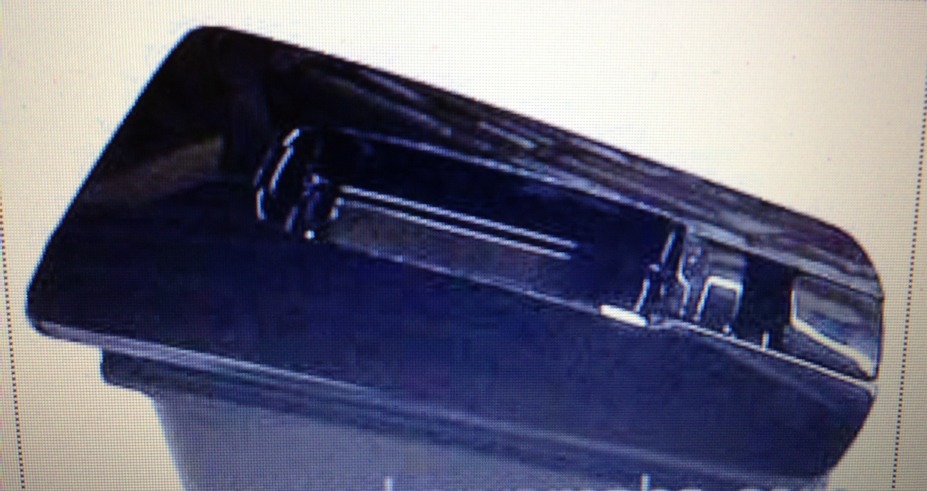

Here is one option that is on the Seadoo's.
I think that one is for a hand held GPS which I found to be useless. (poor battery life, unreadable in sunlight) Have been using the Lowrance and it's perfect for the Seadoo. If it fits in it would be ideal
Wow..."you" found to be useless...with poor battery life and unreadable in sunlight...which unit did you place in that glove box lid...exactly?
If you gotta have the Lowrance.....go for it...find a good glass man...bring him your gps and glove box. I'm sure he could fab somethin up for you...inexpensive too. I'm sure.
I have teh Garmin GPSMap 76, the battery has lasted about a month on mine and can be read easily in direct sunlight... which one did you use in that lid?
Magellan Explorist 610. I returned it to the store as batteries would barely last 4 hrs. Love my Lowrance Elite 4. Large screen, legible, included Navionics gold maps, did not even need to read the manual to figure it out, depth sounder, tracks all routes till you clear them, (need large screen for my 56 year old eyes).
