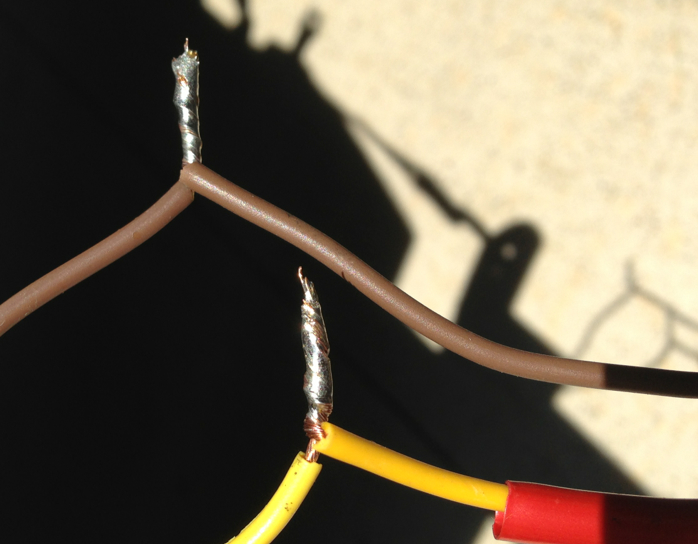

Then I cut into the wire a bit to get to nice new fresh wire, slid heat-shrink tubing onto the wire then twisted them together.
Then soldered the wires,

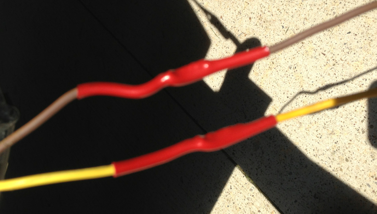

Heated the heat-shrink tube,

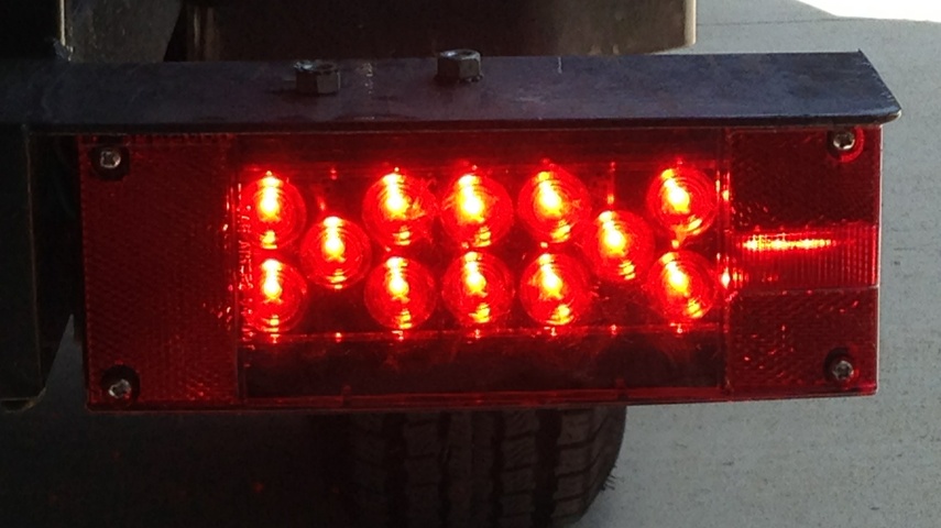

Here are the the light with JUST the running lights illuminated, (in full daylight)

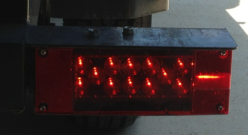

And here are the brake lights, (in full daylight)
