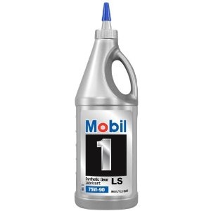

Yeah that good ole rotten eggs smell, mmmmmmm sulfer. Smells like old gear oil thats for sure. I always change them outside now, even in the summer if we have both garage doors openin the shop it still stinks up the place. The neighbors were coming over thinking we had a major gas leak. I use mobile 1. I guess the brand is up to your liking. You could use the seadoo brand too but you are just paying for their logo

I use the OEM oil for the pump. It's GL-5 75w-90 synthetic.
I use that, I think its $12

Isnt that $8 for 4 ounces, well I guess thats not bad if you are only doing a couple, but every fall we do our own 5, then everyone we get in. At $8 a pump that would get expensive quick. I always think bulk lol, anyone know if there is a costco for seadoo parts? We bought klotz once and the seadoo pump oil once, now we always have a bottle of mobile 1 ready to go.

I love the smell of Klot R-50 two stroke oil but never tried their pump oil. I'm on my 3rd quart of the Mobile One like JSG showed this year. I have been accused of having a huge natural leak also after draining a bad one outside (lol).
The klotz stuff is cool, but when you do as many as I do bulk is ideal. I use the marine gear oil b/c it can deal w/ water better than regular stuff.
