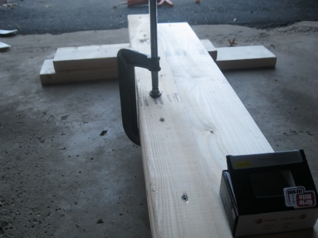

I tried to take quite a few pics of the process so if anyone wants to build one too, they can see how I did it. I used 3" decking screws along with liquid nails to attach the wood. You should pre-drill holes for the screws when you are close to the edge of the boards.

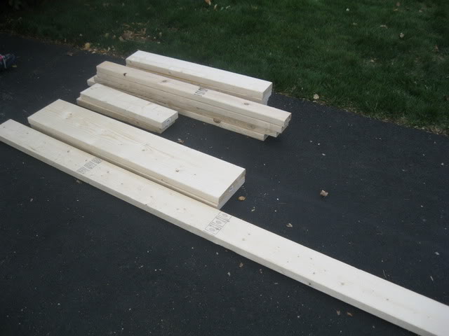

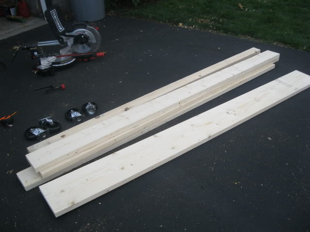

Starting materials

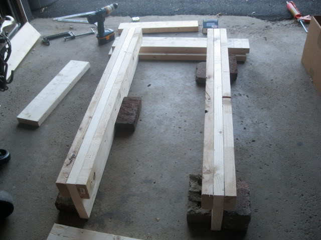

2x4's and 2x10's cut into 4' pieces. 2x6's cut to make (4) 36" pieces. the rest of the 2x6 cuts will need to be made later.

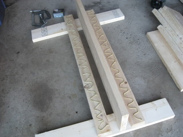

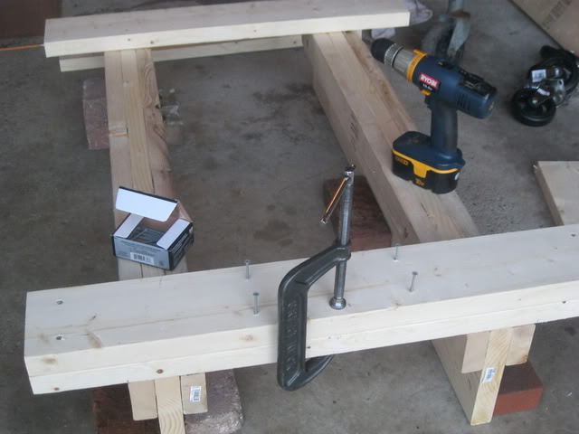

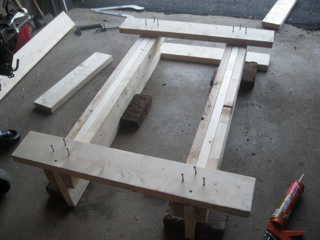

Started by piecing together the "bunks".
After the bunks are put together, space them evenly and attach (2) 2'x6'x36"

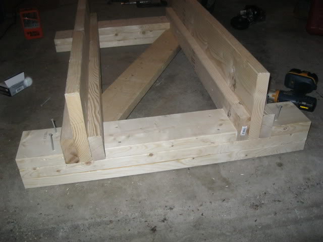

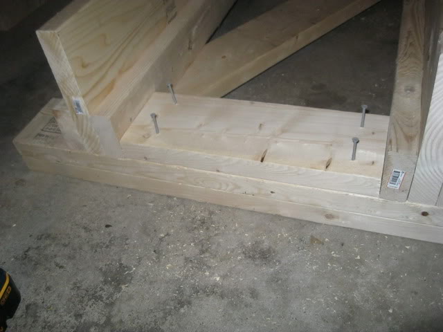

Next, I attached the bottom most 2'x6'x36".

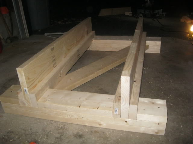

Next, I cut the cross support. I laid the board across in position and used a pencil to trace the angle along the 2'x6'x36"'s it attached to. The angle is roughly 30 degrees. Cut on the large side here at first and then cut it down in small increments so you get a snug fit
Attaching the cross support

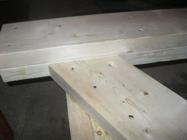

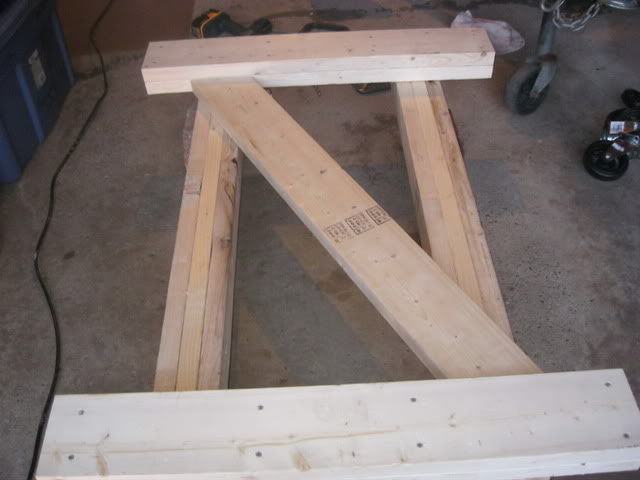

Flip it all over and start attaching the top 2x6 pieces, cutting them to fit.

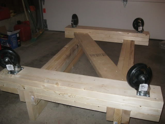

Now, time to attach the casters. I used 5/16"x1 3/8" lag bolts. Be sure to pre-drill holes.

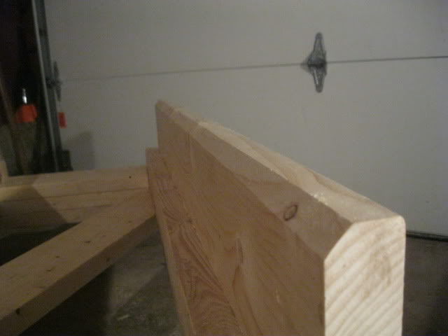

Before attaching the carpet, i chamfered the edges where the ski will rest.
