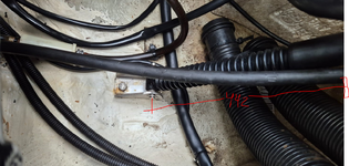

Off topic but on the same machine. I have this machine it runs pretty good but I lost the grate that covers the intake jet. I bought another installed it only to realize the threads are destroyed, i used JBL weld and it lasted about 1/2 the summer and I lost the grate again. I'm thinking about drilling it right though and bolting it on. I'm wondering since you had this taken apart if you know if this would be possible, or would the motor be blocking me from drilling through?
Wouldn't be the motor blocking the forward bolts. It would be the seat support/carrier bearing or fuel tank blocking it.
