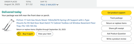

I went through trying to get replacement hood shocks and gave up. Wasn't going to fork over the money for new one from Seadoo and never found an aftermarket one that would be correct. I am weary of buying used ones that may have the same force as my current ones.

I went through trying to get replacement hood shocks and gave up. Wasn't going to fork over the money for new one from Seadoo and never found an aftermarket one that would be correct. I am weary of buying used ones that may have the same force as my current Amazon.ca
Amazon.ca

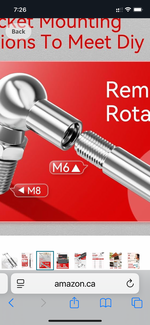

Not sure if this link worked, but I was going to use one of these gas shocks till I got my used machine. I had also found the eyelet ends that will screw into the ends for 11.00
