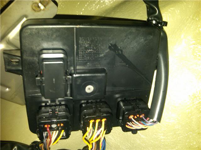

Thanks, I 've done that and all the fuses seem OK in both areas. I put some gas into the 2 cylinder heads and it started for a few seconds. On the MPEM I saw a grey button on the far left connector and I pushed that back in again. Is there anything else to do before I try and get another MPEM. See the type below.
if it started when putting gas in the cylinders, then the MPEM is probably fine. check your spark, check your compression, check to make sure it's getting fuel.
there's no button on the MPEM, I think you are referring to an empty wire plug spot in the harness.
