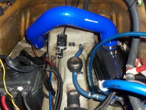

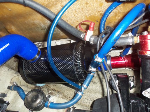

Absolutely, I have red blue and black. $170 shipped on the hose kit that includes main hose, small hose, and 4 non digging clamps.
Alright I'll take a red hose and the exhaust tip. Sending $ now.
The exhaust hose kit consists of the big main hose and the small pipe to waterbox hose. It also comes with 4 special clamps that wont dig into the silicone.

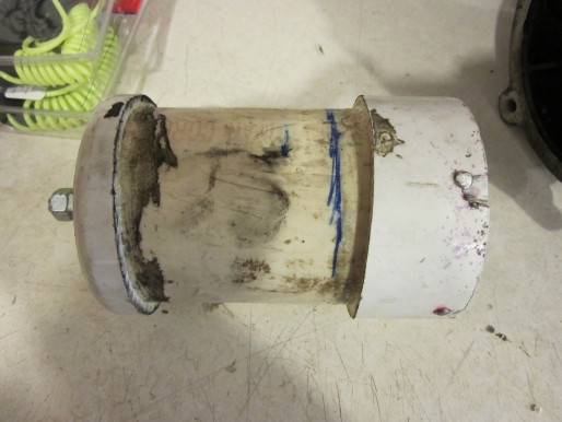

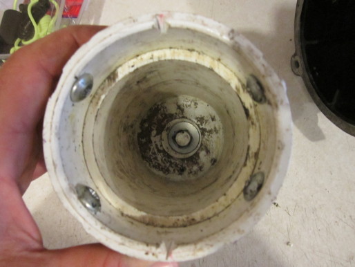

Scott made me realize I never explained what its going to take to get the old one out. Here is what I came up with...well I cant take the credit, my dad came up with the original PVC pipe tool. The OGs can attest. Ive also seen one made with a gas cylinder cap and some welded in pads.
If you want to borrow mine Im fine with that, maybe we send it from one guy to another...It will fit in a priority bubble mailer.

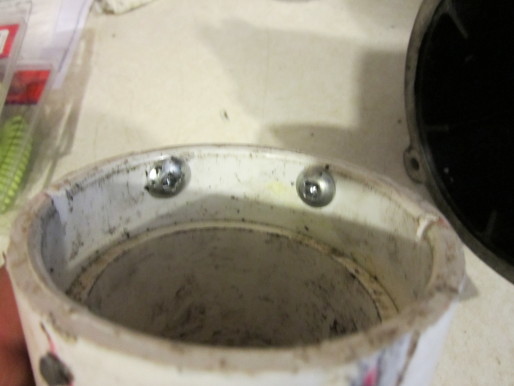

What size of pvc you got? I'll wip some up today
It's 3" then we took an end cap and cut it. You want a small cap and a bigger "connector" so really you need about 5 inches of pipe, one end cap, and a few screws.
Most will come off simply by hand but I added the bolt for the stubborn ones.
