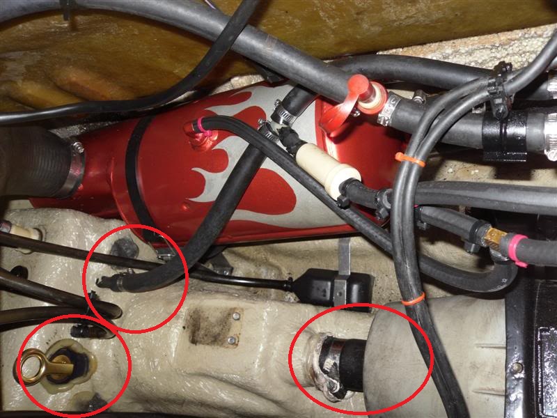

here's a pic of the bilge plug, from west marine, but ace hardware has them too, lower left circled.
i can't remember if I bought 1' or 1 1/4" to cover the hole right, it wasn't that big, you stick it in, then twist it , it expands, then you pop the clamp over to give it that last squeeze and its tight as a nun. if in doubt on the hole, just buy both sizes and save the receipt, return the extra.
based on your situation in general,i'd suggest just pulling and plugging the dam thing, it won't be any more work than replacing the boot :), you can always go back to option 1 later, and your only out $10bux and a trip to the hardware store. right between the 3 circles you'll see the two screws in the hull, those held down the vts bracket, i popped them out, pulled the vts, then just put the 2 screws back in.
