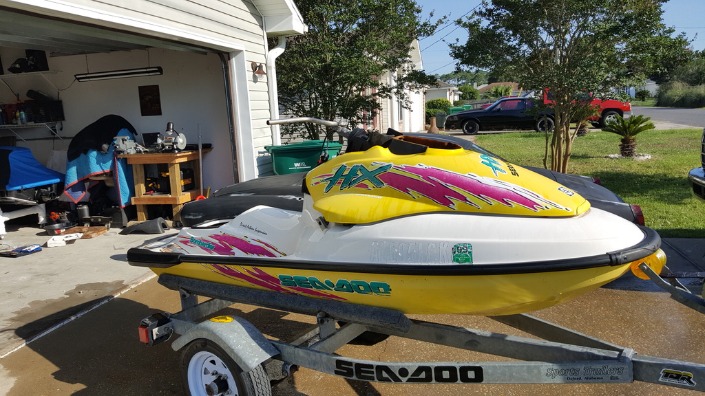

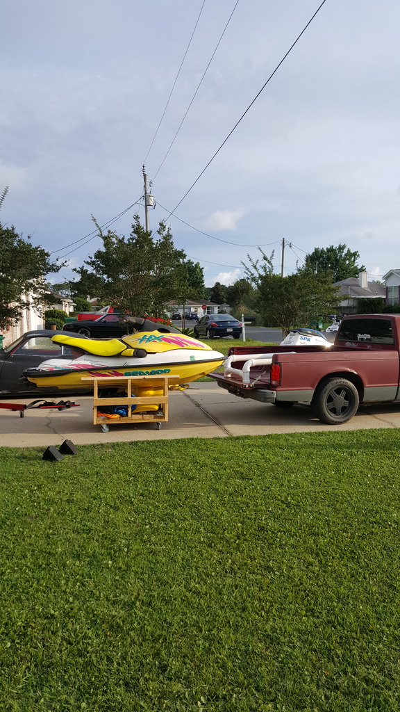

Well as some of you know already i found a HX buried deep in the Fields of Alabama..Old guy wanted it gone so i got it for $200!...After cutting the weeds grown over it and evicting the bees nest..we got it loaded up and got it back home.

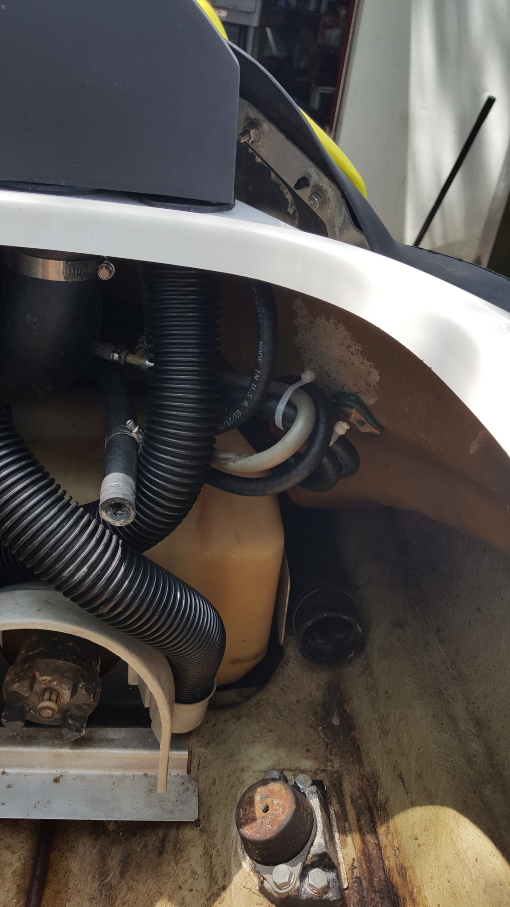

The next day i got a good look at what I'll be working with..Ski was all original and looked like it was never touched..The bottom of the hull was mint with a few lil scratches...found no rust or any corrosion on anything which was surprising. Motor was locked up though so i knew that was probably toast.

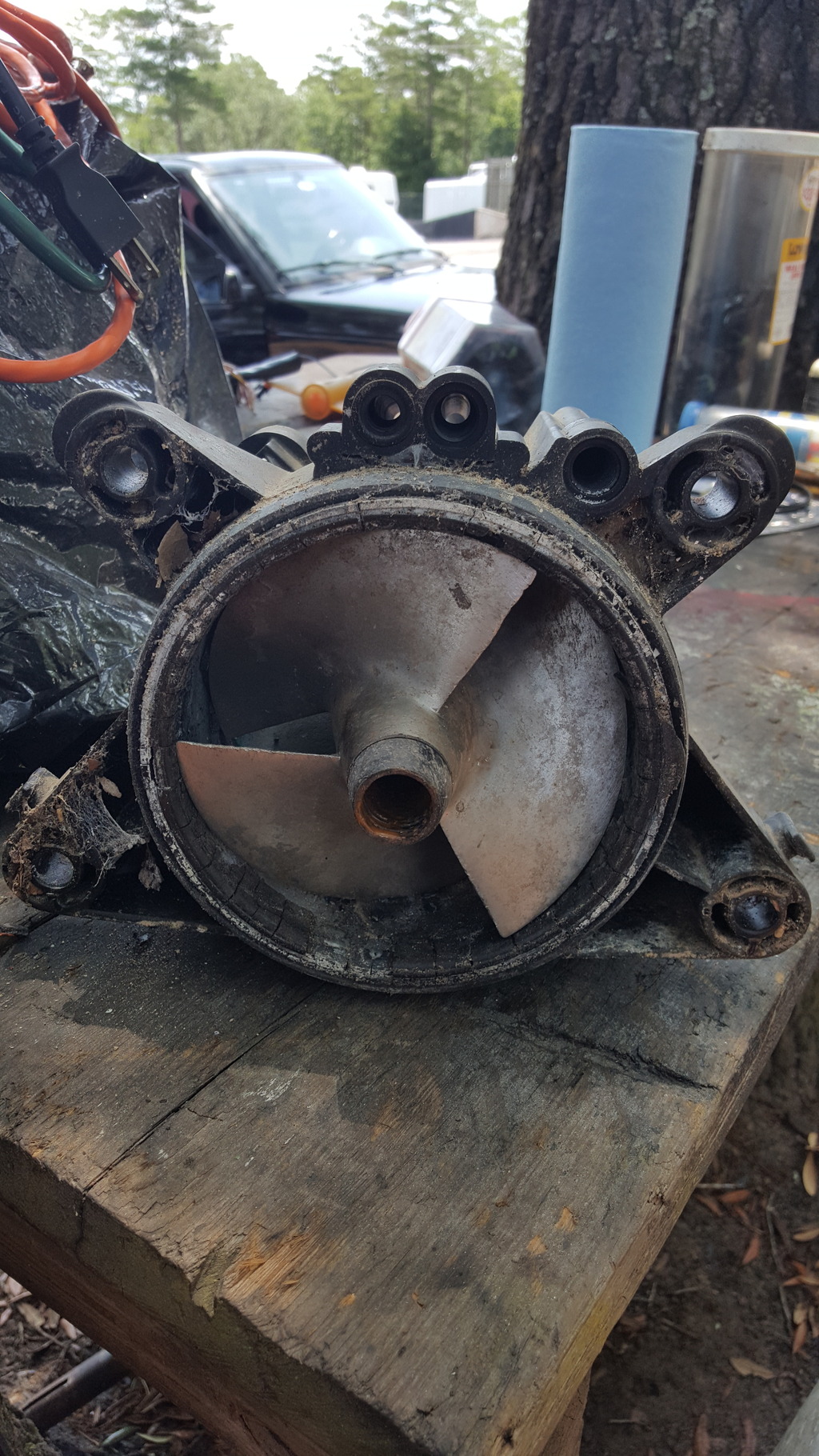

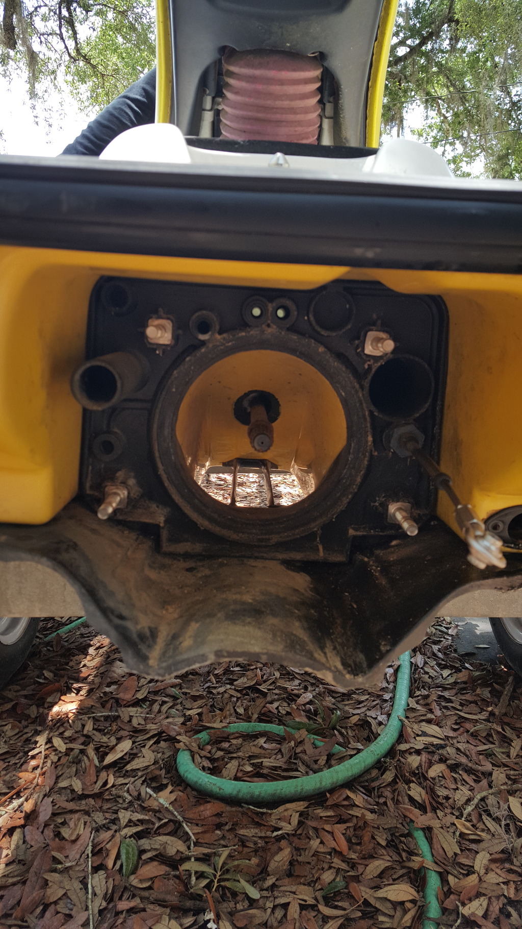

Got the pump removed and of course the wear ring was disintegrated and found damage on prop

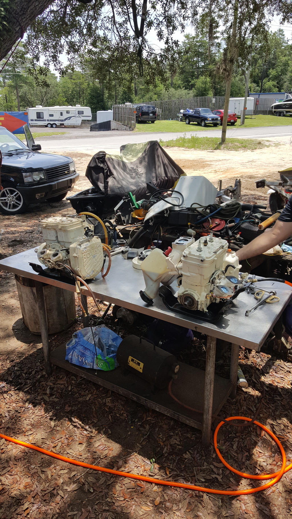

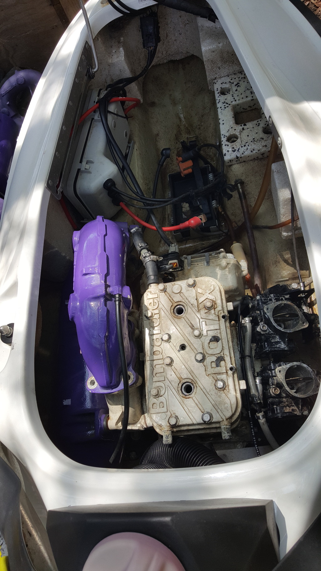

Old motor out (on the left) new motor ready to go (on the right)

New Wear ring and Mint used prop Matt had!

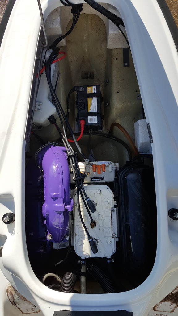

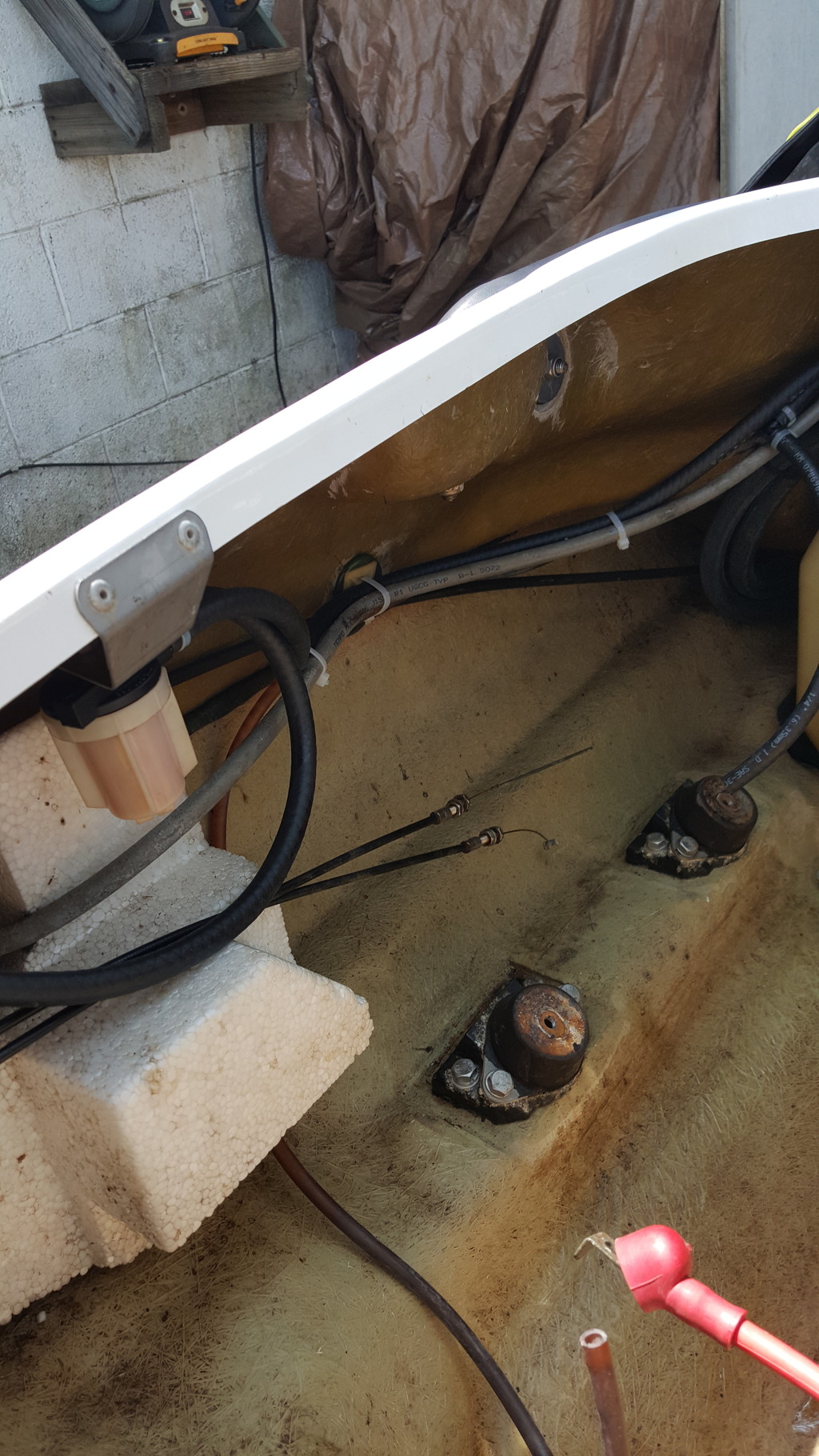

Motor installed, New battery, Ready for carbs and fire up!
All this was done in one day..The Matt & Zack 1 day ski overhaul lol. Matt filled the carbs with fuel and she popped off right away and purred like a kitten..We smoked out the local restaurant so I know we did a good job!
