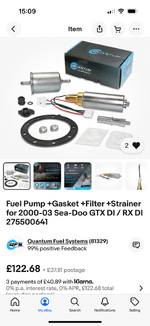

Think I’m gonna get this one off Amazon and ok I’ll use that mixture thanks.
Ain't going to work.
There was only one time I heard of an AM pump working but I don't remember who found it or what one.
The issue is that the OEM pump is high pressure but low amp. All of the aftermarket ones that make the pressure pull too much power and mess with the ECU so they just don't work.
Gotchya iguess it’s good I got returnable then then thankyou.
The pump you showed worked for me but they made another one recently which I have tested fine on my 2002 GTX DI and supposedly it is better for the DI’s and you don’t need to modify the fuel module.

I don’t agree with this as I had two seperate pumps from quantum and both worked fine!
So I bought an entire used fuel assembly to avoid the power draw problem I through the gauge on it and it fire right up. So problem was definitely the pump. I might return that thought if I can use the quantum pump I posted and return the used pump as it’s $200 cheaper. I think I should still replace the air injector that got beat up when the rear piston went bad.
