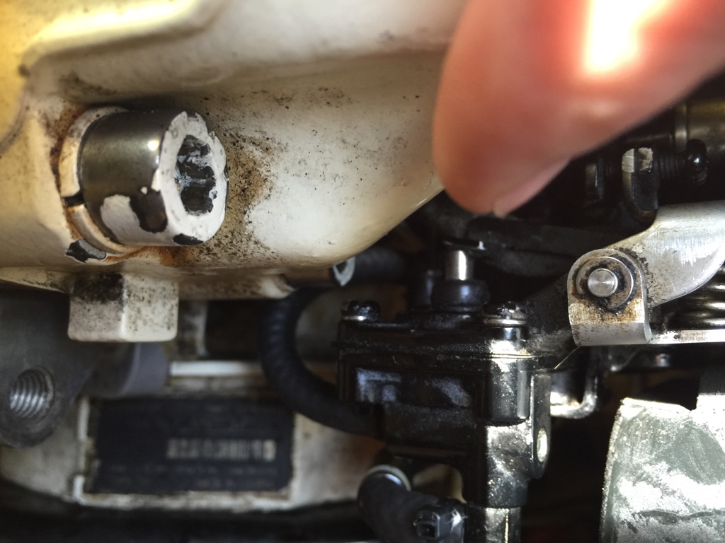

JJinSC Well-Known Member Jul 27, 2015 #1 How far in is this little plunger suppose to move when you fully press the throttle lever? Mine only seems to move about 1/8" Sent from my iPhone using Tapatalk
Dr Honda Well-Known Member Jul 27, 2015 #2 It doesn't move much. The volume comes from the size of the diaphragm, and the bleed jet. The timing comes from the screw on the cam.
JJinSC Well-Known Member Jul 27, 2015 #3 Thanks, so I want to check the timing on the activation on the a-pump. I know I have read how to do that somewhere but it is not in my shop manual for this model. Can't seem to find it anywhere on the forum here. Sent from my iPhone using Tapatalk
Dr Honda Well-Known Member Jul 27, 2015 #4 Yep... they were nice to leave that out. I would head over to Mikuni's web site, and they have all the data available.
