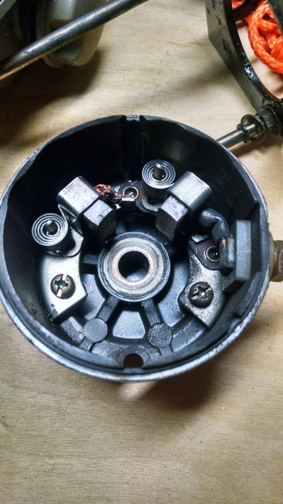

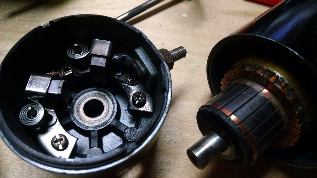

Well I thought I fixed my starter after it stranded me last weekend but it did it again today. I was trying to tap the positive post on the starter and when I touched the wrench to the inside post nut and starter body at the same time while pressing start it finally turned over. What would cause this? I tightened the inner nut nice and snug other day and thought it fixed it but apparently not. I probably started it ten times today before it did it again. It's not the solenoid, that has been checked and Im getting full voltage at the starter, but only a click at the solenoid. Should I get an OEM starter or what? My brother has bought several car, jetski, and four Wheeler starters from one eBay seller for years and has never had a single one go bad. Can't remember the name though. D and b electric or something like that. Where do you get OEM and how much? Or does my issue sound fixable with a rebuild? Seems I have a bad connection in that starter post. It cranked fine the rest of the day. Also, is there a legal length maximum on the Layard? I pull mine off constantly while playing. I'm wanting to add about a foot of length to it.

Goki was a great aftermarket starter, when I got into seadoo's back in the 90's. They were in the $300 range too. But I'm sure any one that is around now that is marketed as a Goki is probably trash. The reason I asked was the brush holder is way weird on your starter.
Oh, maybe it's worth rebuilding then. My brother said that starter was bought local because he had no internet then, so it's old.
The bitch is, where do you get parts? The brush holder is completely different from OEM. All the posts available are just like OEM. You'll need to find an old school electric motor rebuilder local to see if he can chase down parts. I think Goki used to cast their name in the housings, but I could be wrong. That's going back 20 years. Again, this is all an assumption that it's a Goki.
