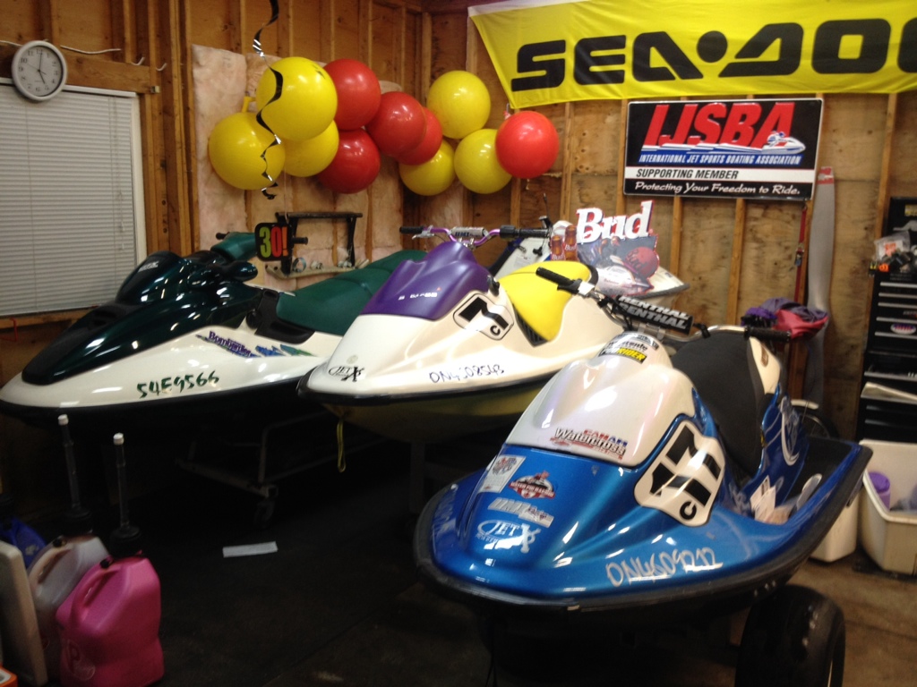

I think seadoo yellow is the ugliest. ESPECIALLY when someone takes a 96 XP and strips the decals off of it. That's not even trying. Looks like the whole boat was strung from the nozzle and dipped in yellow paint....

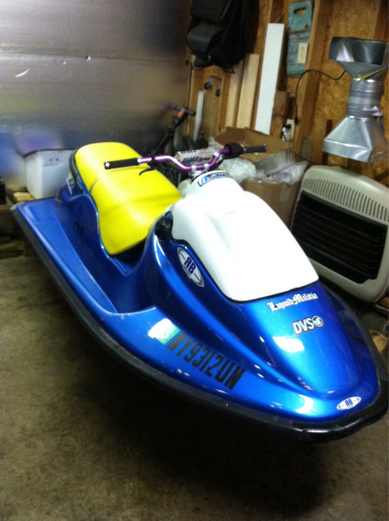

My blue I'm not fond of either, but it's what I have and I made the best of it. Blue top deck, black bottom, black seat and turf, white lettering, white race numbers, white hood, white accent on the seat, and the registration numbers and bud light decal are brushed aluminum vinyl.... it works, and it works well.

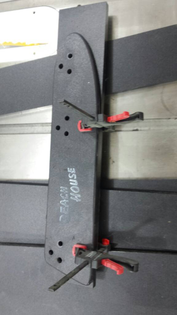

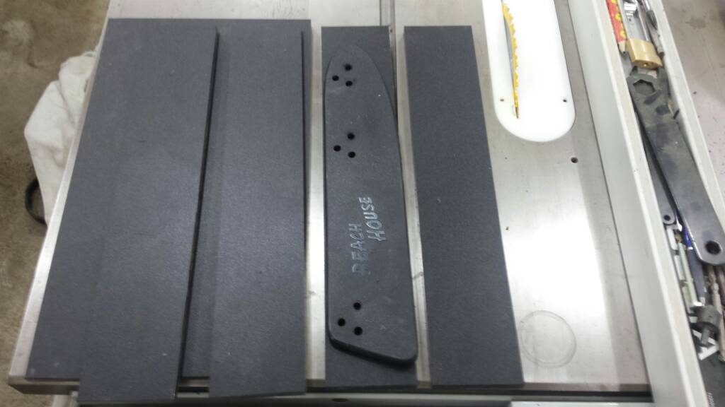

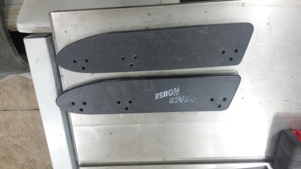

Nice work on the sponsons btw
[MENTION=57920]racerxxx[/MENTION] would be the first person I would askthanks for the info on the vts. Also thank for the complement on the sponsons. any idea on the squish?

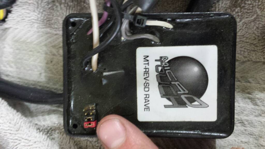

4. I need to jumpers to set it for number 5. Where do I get the jumpers or what have you done...make one?
You need to run a 3 hole to get what you need. When you put the cylinders on did you torque them down? I torque then down to get a real world reading. Also, remove the cylinders, take a straight edge and place it across the cylinder mounting holes. I'll assume they're probably proud of the deck surface, typical. If you're careful you can hand file those flat again. Any variance in the deck surface can mess with your squish.
