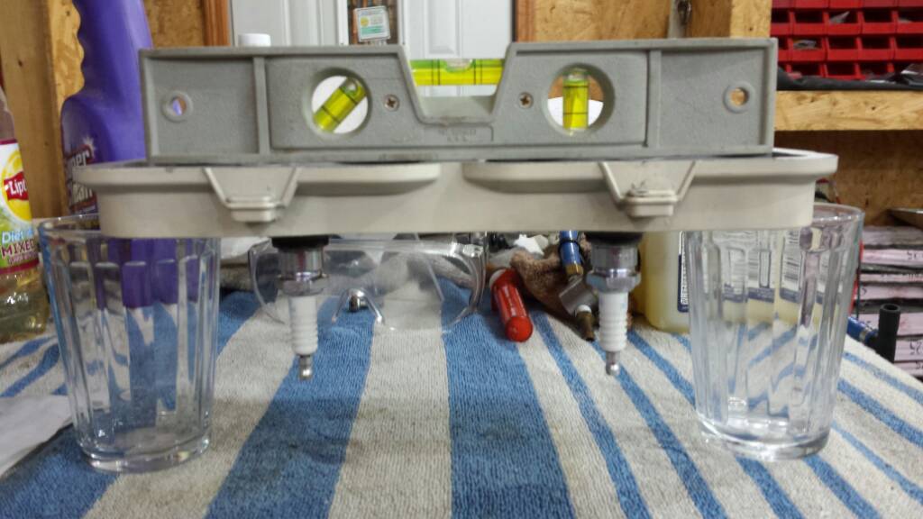

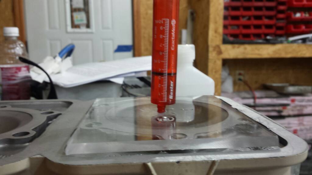

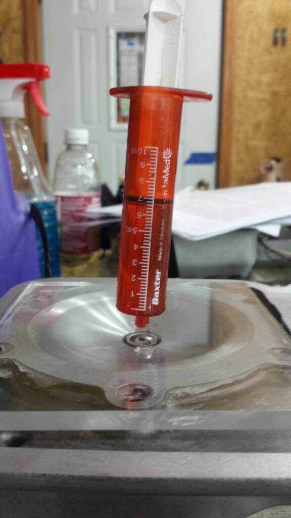

Yes GroupK is trying to give your stock ski a good performance improvement. When you bolt a Spec 2 on, it alone will make a monster out of your ski. Personally I would never go that low on squish but it's not really an option with a race pipe unless your running the best of racing fuels.
It's a trick to run a full race pipes on pump gas. You need good carbs and then you need wide squish and you have to back the timing off a little. You will also need to get the pipe for a little more water then the racers who run right on the edge.
thanks for the info matt. I am only running a spec 1 though. From what you said though, I think im going to go with the 6 hole gasket. That will be me .053 - .059
