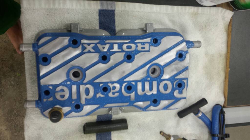

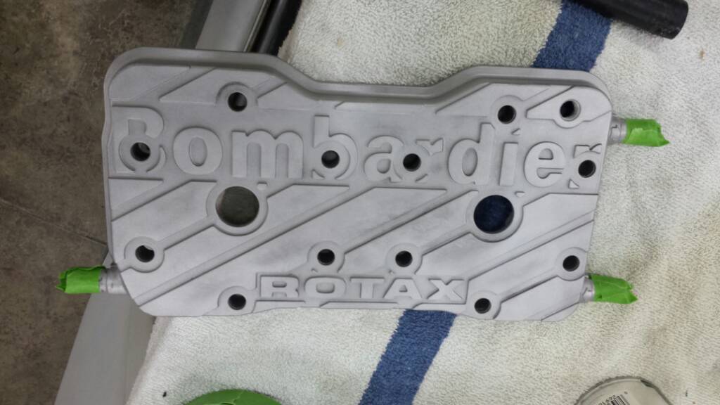

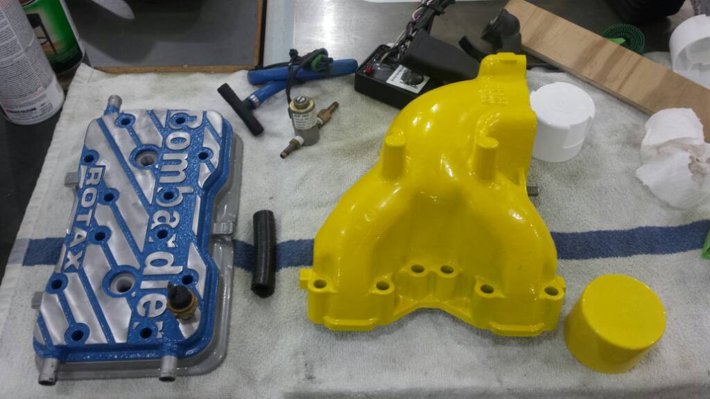

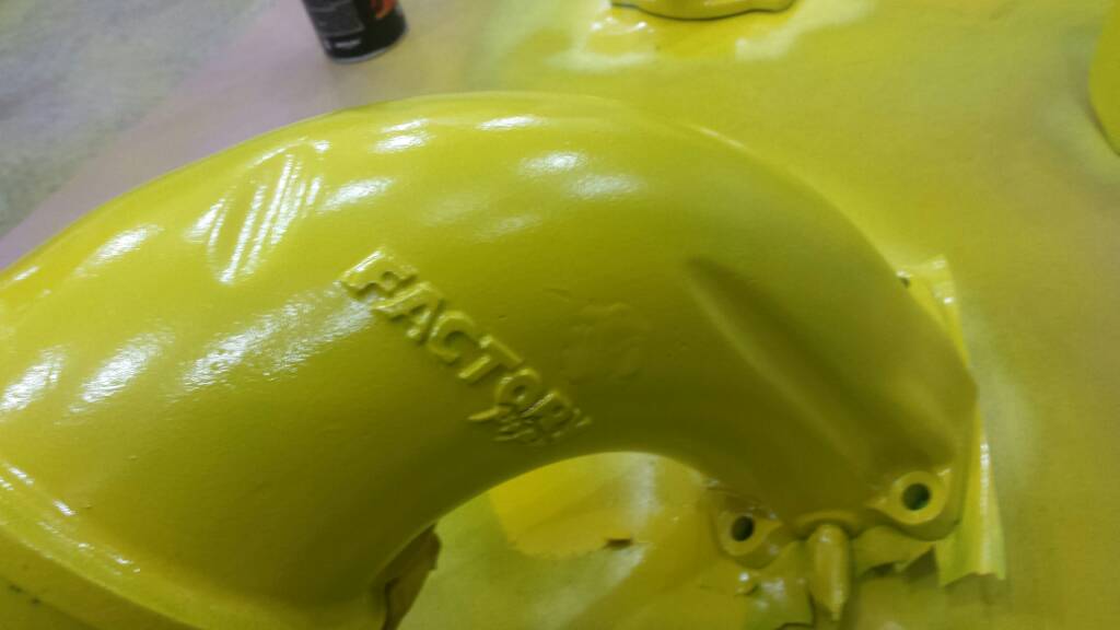

Also last night I sandblasted the head cover again and painted it blue and tonight I'm going to sand it and clear it

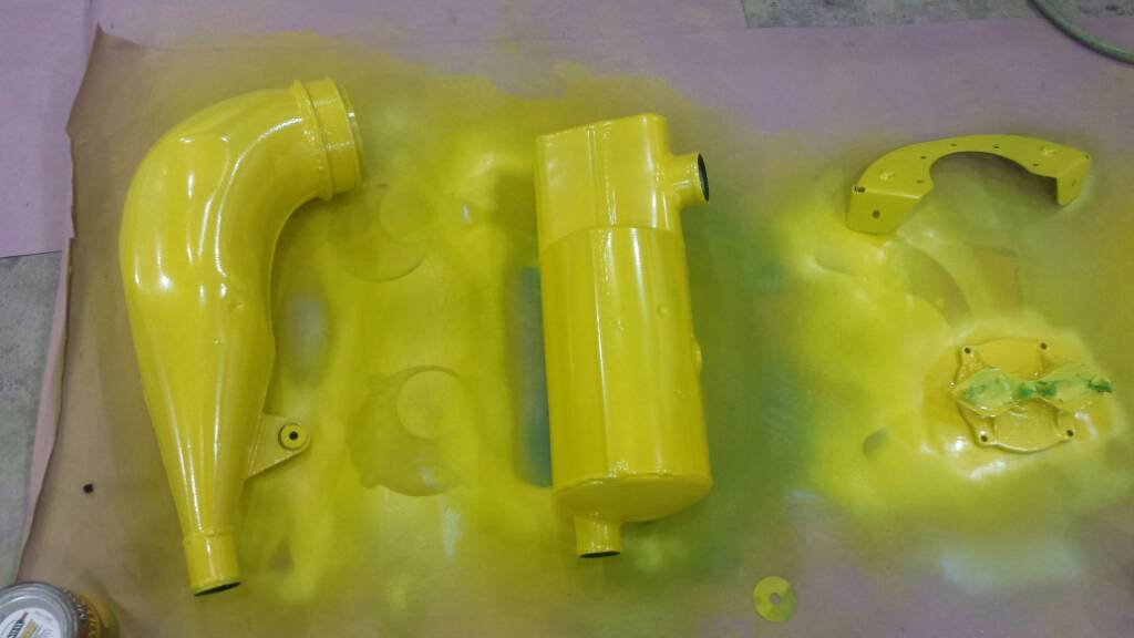

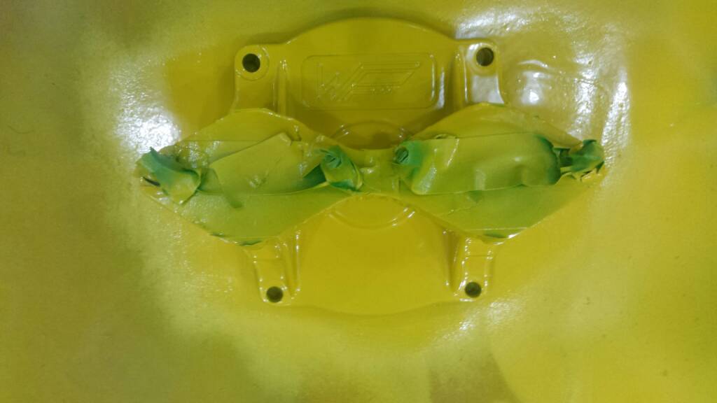

Well got the pipe sandblasted and got it painted tonight along with the head. I'll post up some pics tomorrow.

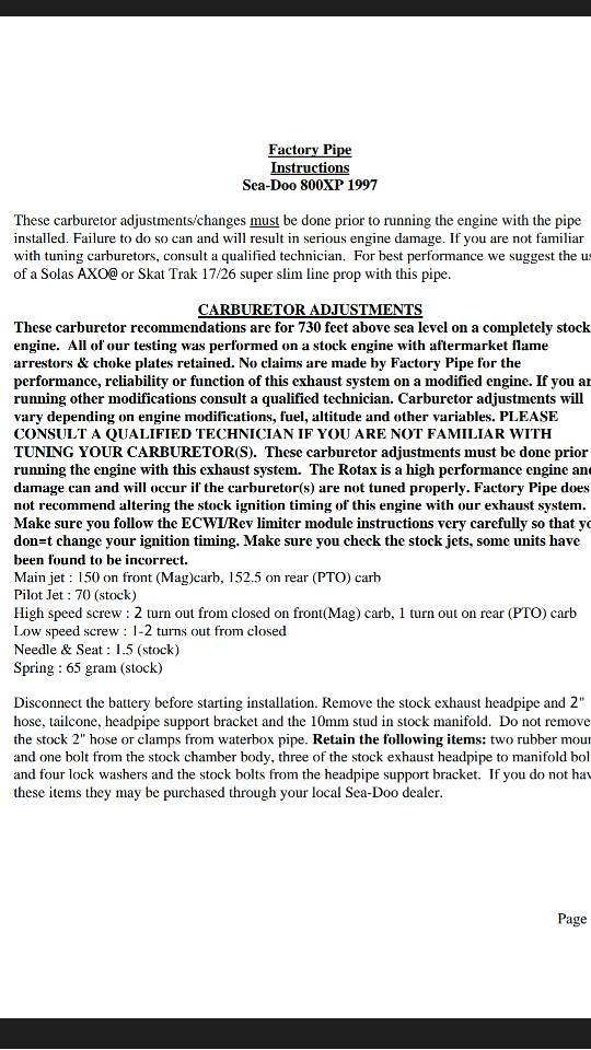

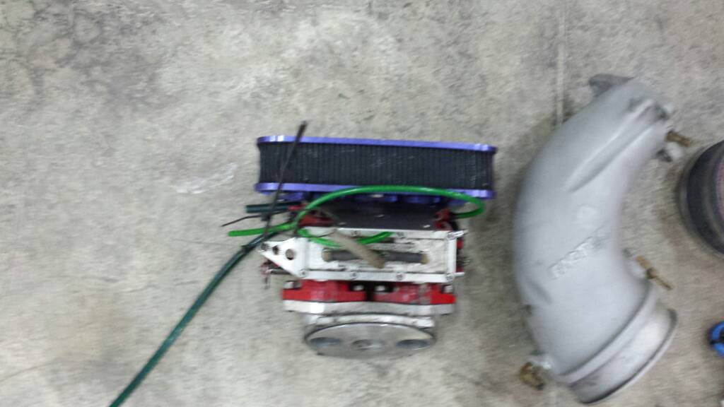

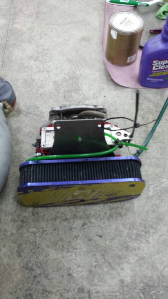

On another note I'm working on the carbs now and just working my way through them with cleaning and seeing what I need for set up. I was reading on the factory pipe Web page and the settings they give are for a stock motor and carbs, seeing that mine are not stock would would you guys do? My carbs are 44s. And it is a spec one pipe. This is what they have on there Web page.
