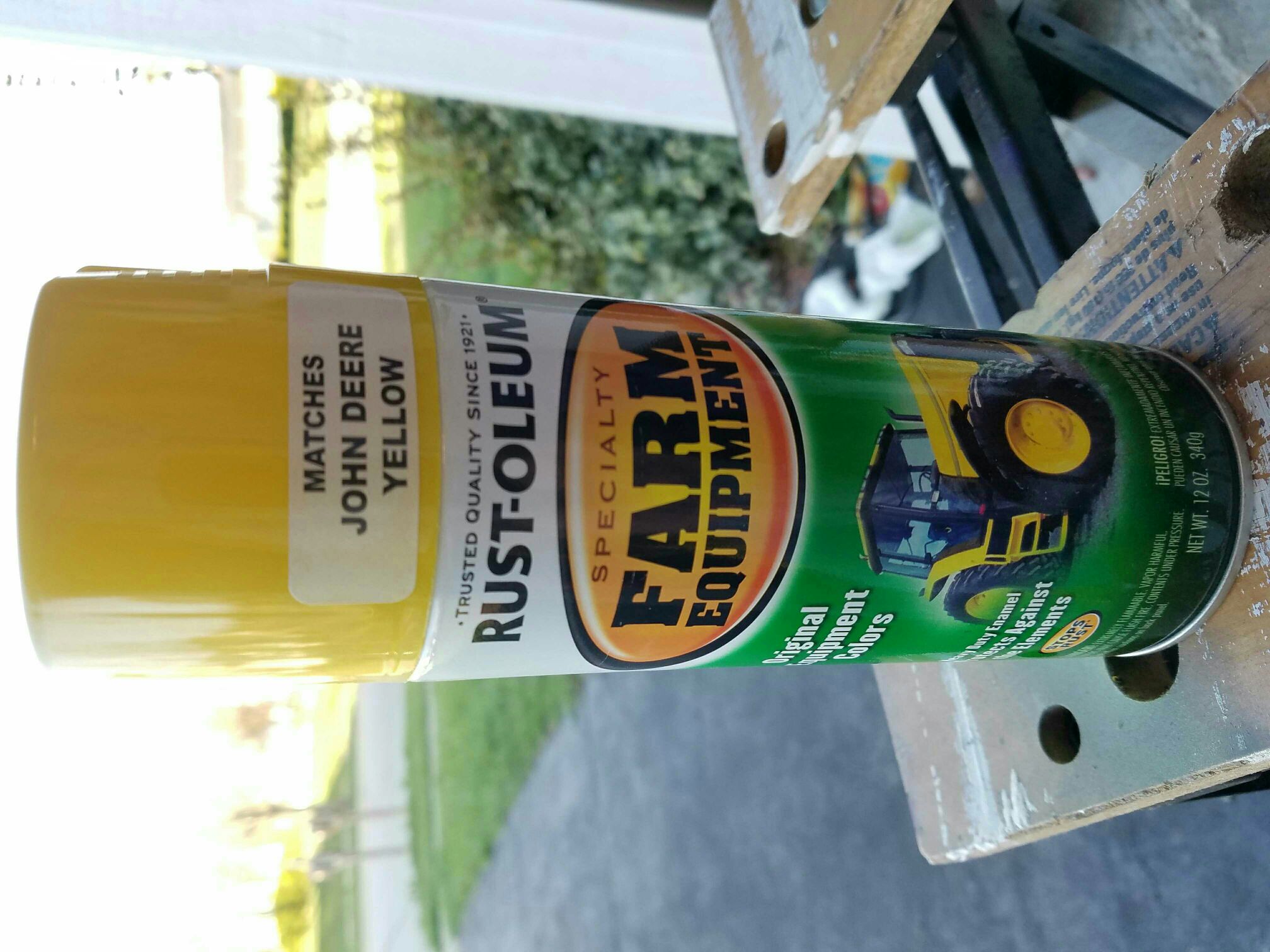

I'm def not spending the coin it takes to get a single gauge hood just for that. Before doing that I'd epoxy the hole shut and paint it for $5. And no don't worry I would never do that.
i picked my hood up for $25 shipped
you can do it. just cant be scared. like ankeneyou said, the rattle can will work just fine and if it doesn't turn out just sand and do again...

I had the Seadoo yellow matched, the John Deere was closer lol
Damn, i've tried multiple Lowes and Home Depot and none of them have it. I've seen it on eBay and Amazon for a decent price though
