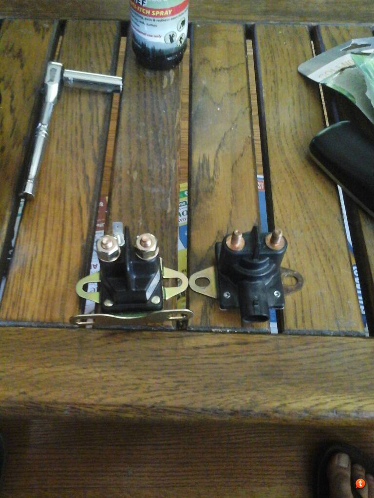

If that solenoid is bad and all else is good then you can cross it by connecting the two larger top posts with something metal like an old screw driver. Put your key on with the rear black box pulled up and cross it after the "beep beep" it should fire up.

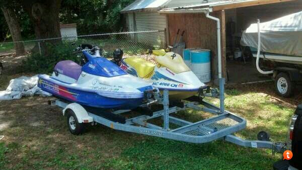

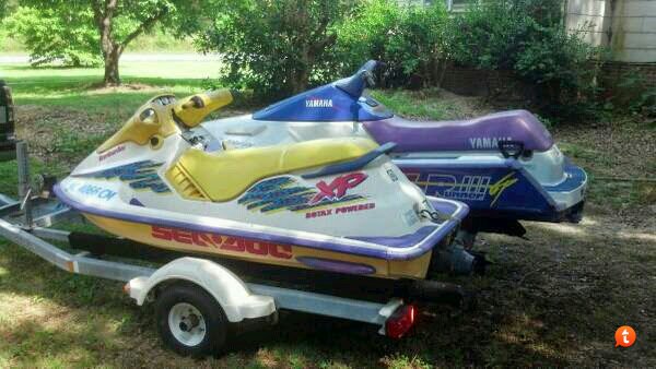

Didn't wanna post a new thread so I'll just keep it on here...my fiance loved riding my xp so I'm trying to surprise her with one of her own. Found this on cl, talked owner down to 300 from 600 and trailer is included. Supposedly ran when parked 2 years ago. Has title, key, etc. Think it's a good pick up? View attachment 25692

Update on 95 : picked her up today... runs after a little coaxing, definitely needs to be worked on. Main thing I noticed was it was running super rich, with watery oil coming out the exhaust. He was still using the oil injector for it, so I was wondering if I bypassed out and started using pre mix, would this help the problem?
