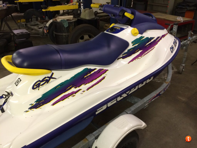

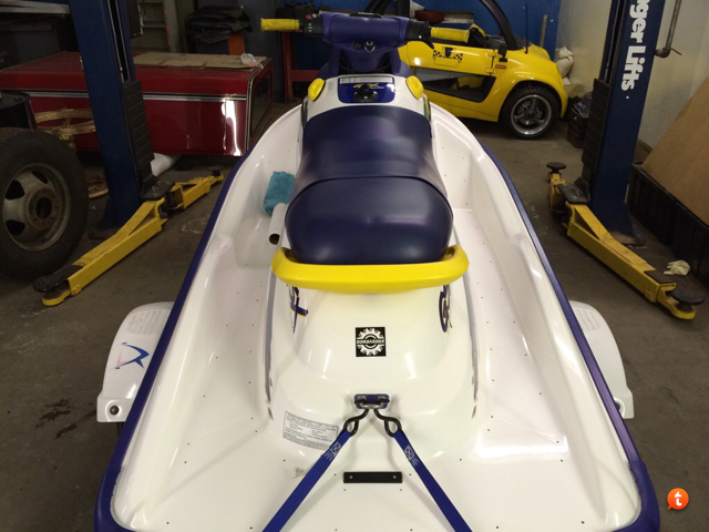

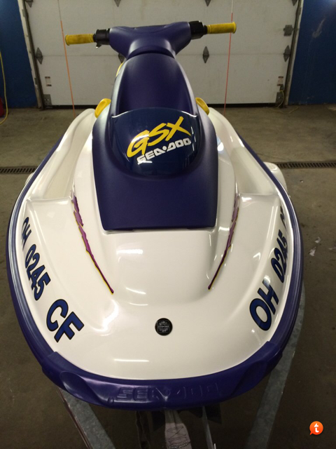

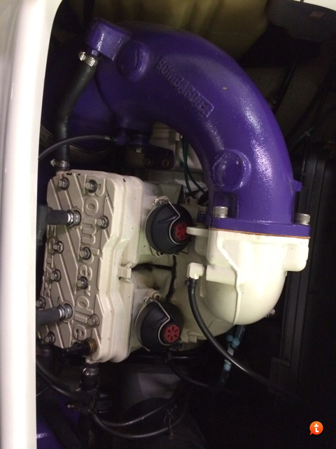

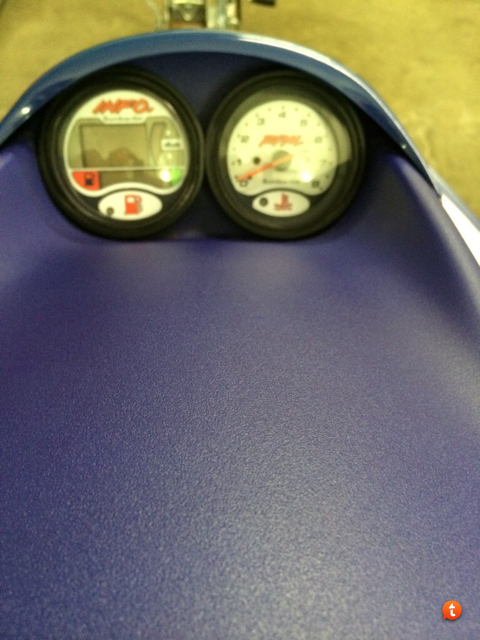

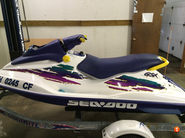

So here are the pics of the 96 GSX. Mats are off the ski, hydro turf on the way. New grips, and start button also on the way. I've done new fuel lines, new oil lines, rebuilt carbs, and new reg. numbers. Let me know what you guys think!!!
looks super clean. You can really tell it has not been stored in the sun. If it runs as good a it looks, you got a nice ski.
She is super clean, top to bottom, no damage, no dock rash, no beaching marks!!! It's perfect for my wife!!!!!
Looking at the motor, the head has been removed, did they mention a top end job on it? Looks great BTW!!
Ski was at the dealer with a rave problem, and was fixed under warranty, I have all the dealer records from the owner. I am the second owner.
The raves were covered under warranty??? On a 96??? What was the problem with raves?
Well done buddy, another minty fresh one. I think your wife will be very happy.
