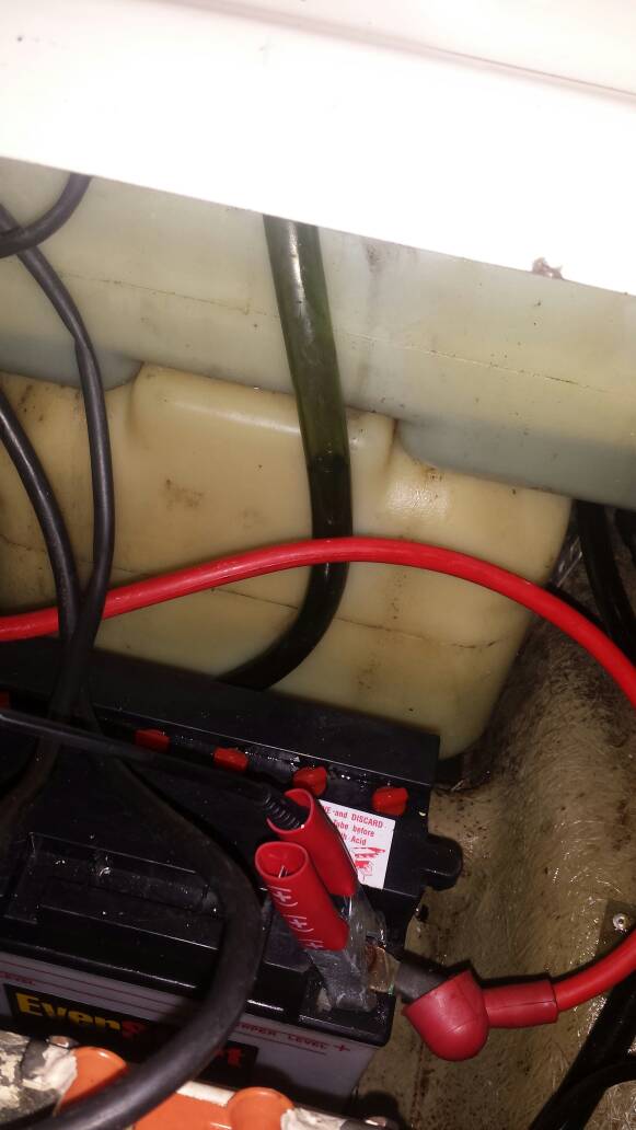

She turns over by hand no problem. It's weird bc she was cranking with one press of starter earlier. I'll check out the electrical
Sometimes the bendix inside the stator housing can get stuck, or maybe your starter needs rebuild (OEM starters are the best ones, so rebuild if it's original), starter rebuild kits including new bearings and brushes are available.
Aftermarket starters often aren't very good, could be yours was replaced?
I don't think it's the starter. It seemed strong as hell up until this afternoon. I've had a weak starter before that was going out, and this didn't seem anywhere close to that.
This bendix theory might be something though...hard to fix? seems like it would be unless there is some secret squirrel stuff that I don't know about
i'm not even getting juice to the solenoid it seems. battery is juiced up 100%. guess i'll have to dig around and find a meter and start checking wires
Whelp figured out the electrical issue.... terminals needed a scrub.
