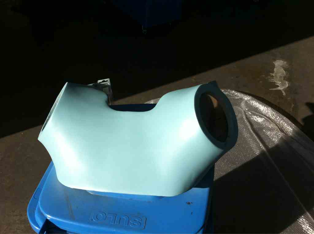

Here are some pics of my latest install. This is on a 2012 Seadoo Wake Pro 215. After 2 months, I couldn't resist. The sound is amazing and loud.
Specs: Kicker everything: ps5250 speakers, pxi50.2 amp and controller, px200.1 sub amp, 6.5" CVT651 sub

Aftermath 3x 5" Holes
If you say so. I would have thought of another way besides cutting huge holes into my hull. Maybe finding some sort of bracket that will bolt on with a single 3/8" bolt on either side. Does the stator even produce enough amps to power all this stuff?

I'm not concerned about the hull, because they are located away from high stress points. Also, the speakers will help provide support, if needed. I just have to check to make sure there isn't any cracking, and if there is, all I have to do, is reinforce the fiberglass with more. I didn't want to use an external box, because I wouldn't have anywhere to put it. My install is hardly noticeable, and nothing external sticks out.

I've searched for different types of brackets, but everything sticks outside of the original design. These amps are made with a low amp draw. Max for the sub amp is 15 amps, and max for the speakers is another 10 amp. Kicker says the usually use about half that at normal operation. This is pretty low, considering a normal 750watt amp has at least a 80 watt fuse in a car. I've been searching for the "stator" specs (I'm guessing thats like an alternator), looking for amp output, but I cannot find anything.

Lol, no I did not engineer the hull. I'm not saying these are not stress points, but through my mechanical engineering knowledge and logic, these locations are of low stress concentration. The radius on these cuts are large and better than smaller ones, in terms of rate of crack growth. So, I have nothing to worry about.
How do you know they are not at stress points, did you engineer the hull?
