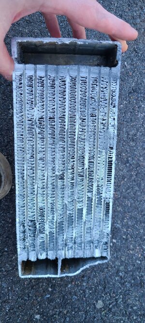

Any common failure spots to check on intercooler? I’ll be able to see if it has a leak while it’s running?
You need to pressure test it. If it is run in salt water the plugs might show pitting.
If it is leaking you typically notice things like throttle hesitations and bogging or flat spots.
The are aluminum, so they stretch and crack or spit, like mine which was actually water sitting in the air side. That is why blow mine out with compressed air on top of running RV antifreeze in the water side. (I bought my machine with a leaking IC. I replaced it with the newer 300 IC)
