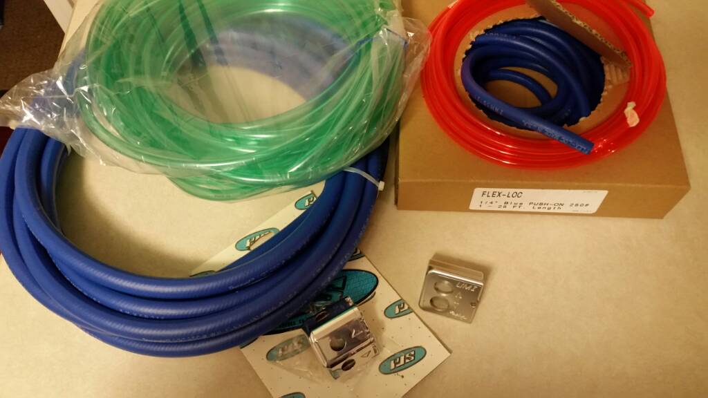

I did get hoses, button housings, and a Hydroturf splash guard in the mail. I was sick of never having enough hose so ordered 25-30 ft of each just to have in the garage, lol.
where did you get your blue hose?

Both Blue hoses I got from McMaster Carr and just looks like heater hose. The other colored hoses were amazon specials.
