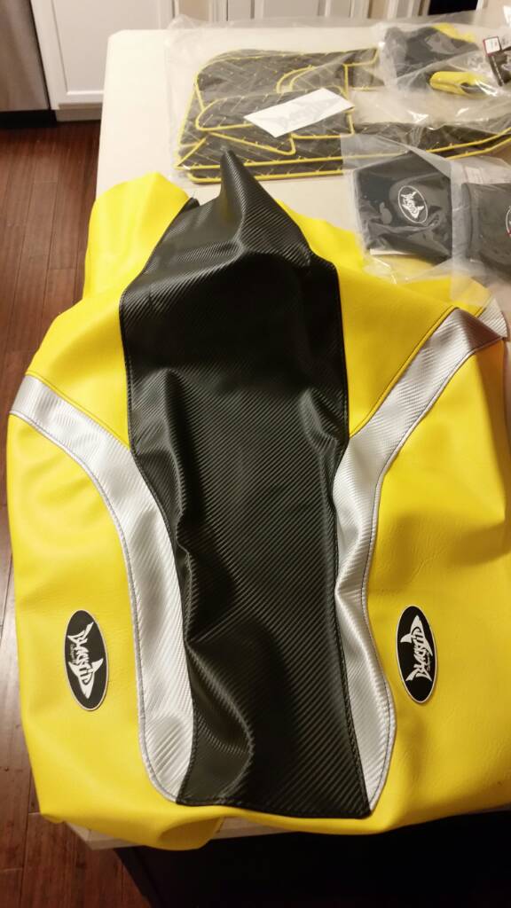

This is what I ordered:
If you want to save on shipping, just have him ship you the foam and use your pan. WAY easier to ship and cheaper.
Think a foam company could make a mold of a hump seat and reproduce just the foam for people to buy? Feel like there could be a big market for that
I was thinking the same thing. Originally I was just going to go to an upholstery shop and have them make one but I wanted it to be exact and I didn't have one for them to use as a template.
If someone could clone the oem foam they could be vacuum packed for shipping in a pretty small package.

Blacktip does have a hump seat cover now. I believe it is called the touring cover but it is designed for the hump seat. Not that I'm saying go with them over jet trim. Jet trim is top of the line and they can make you pretty much anything you want.

Thanks Adam I'll take a quick look before ordering the jet trim.

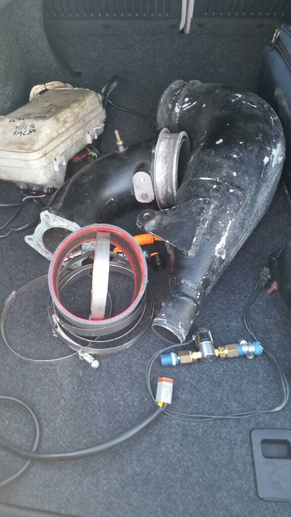

Stopped by to see Jess today and grabbed a Factory spec 2 off of him. Has the rec chamber, injection, Rev limiter and stinger.

Also just went through airport security with half the pipe and manifold in my carry-on. Was funny to watch them study the xray image repeatedly, lol.

I've also got to start on making a bracket for the pipe since Jess wasn't able to find it. Shouldn't be too difficult but would be nice to find one to save time.
Will do. I was going to just make it functional but now you'll force me to worry about aesthetics, lol.
