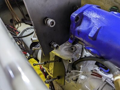

I was proud of myself for making these block off plates but they all leak LOL. I used the old gaskets behind them and they are good and snug but they all blow bubbles. It might look like those long bolts aren't holding the plates on tight but there's a nut further down on the thread torquing the plates on. You guys like using tire tubes instead of the old gaskets to make a tight seal?

Use Plumbers Test or Expansion Plugs. The big one for the Exhaust can be found online. Google it.
Wipe the Oil off the inner walls of the Manifolds to avoid Plug slippage.

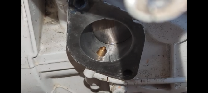

Alright update time...
1) Squish in spec. 1.20+
2) Pressure tested. Slow air leak somewhere.... Real slow but losing a pound every couple minutes. Cant find sprayed the crap out of everything with soapy water including gauge etc. Maybe need to access crank seals and spray?

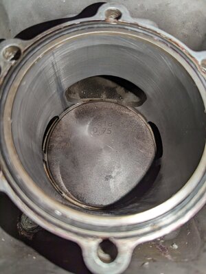

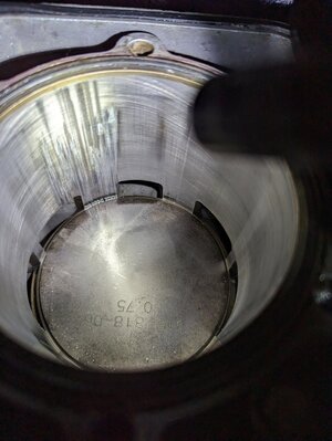

3) Got anxious and pulled top off. Pics and video below...

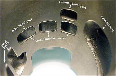

First off, I don't see any chamfer on the ports. Who did the machine work.
I also don't see any piston wash so is it lean or starving for oil?
Frack. I took it to a reputable shop known for accuracy, but I didn't get it checked by my 2-stroke expert after the shop was done with it. They did say it was chamfered... as they go around all the little ports with tool to take the hard edge off. But you're saying it doesn't look like it so maybe it's not a good job?
Yeah not sure about the Piston wash either as it didn't get much run time though.... My two-stroke buddy was saying it look like it was starving for oil as that Teflon coating was all worn down on the Piston side.
Do you have a good picture or link of what a quality chamfer looks like?

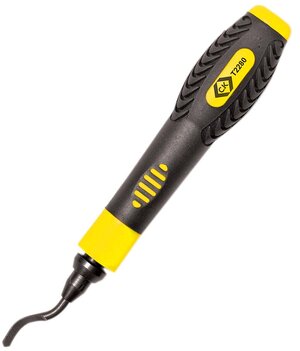

Chamfering requires the use of a Porting Tool, Dremel Tool or Small Grinder to create a BEVEL all the way around the Ports.
A Deburring Tool does NOT Chamfer the Port edges.
Only have 2 Stroke Cylinders Bore & Hones done by a 2 Stroke Shop.
Any other Shop, either doesn't know or forgets to Chamfer the Ports.
I don't have a good picture but I honestly don't see any on yours at all.
This would cause it to catch a ring.
Typically when the lean seize or oil seize the damage is on the exhaust port side.
Yours is in a strange location which makes me think the piston to cylinder clearance was not setup correctly by the machine shop.
I have seen a lot of cylinders damaged just like this by really good automotive machine shops that have no clue how to do 2-strokes.
All right I'll get this pulled apart and over to the two stroke expert for autopsy.
