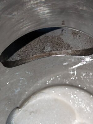

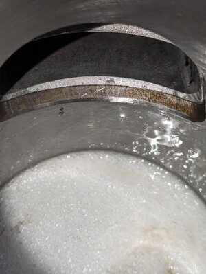

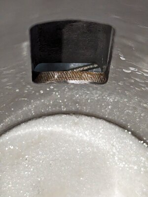

Hey @mikidymac . How do you like the look of this chamfer. Better?
