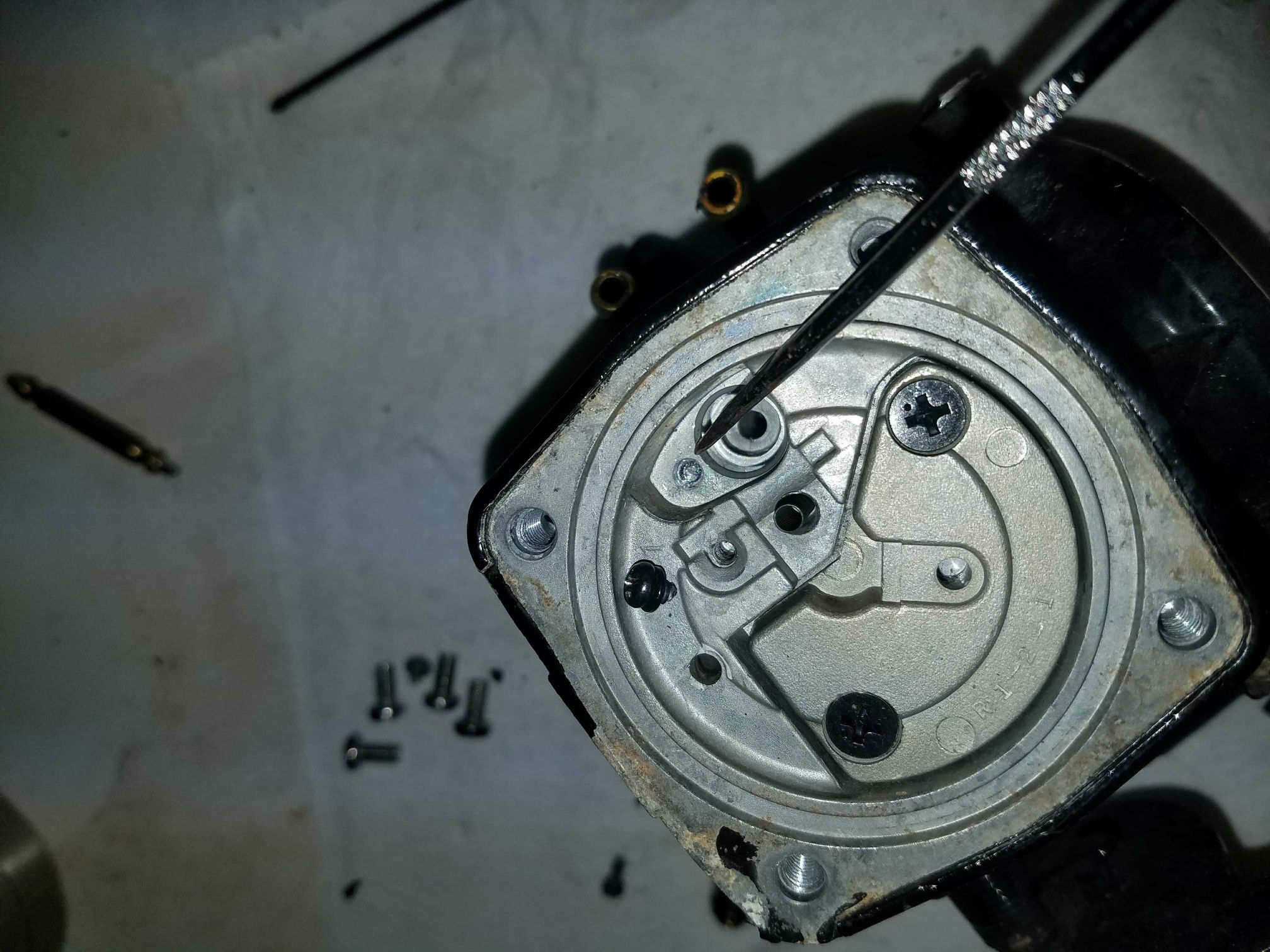

So I took the carb off of the GTI to rebuild it with the OSD parts kit. I got the internal screw set added on based on my experience rebuilding the carb in the GTX. Unfortunately the new screw that holds the bracket for the seat broke off as I was tightening it. How do I get this out? I'm pointing to the screw that is broken off in the hole, the broken head is next to it.
Well, hopefully you didn't cross thread it. Try using that pick to unthread it. I've gotten lucky before
Try the pic. But your best shot will be to take it to a machine shop. One that does engine work and have them remove it. If they have a tig welder which they should they can prob weld it out and won't damage the carb. Takes some skill. They'll also prob have the right tap to clean up the threads. Then you need to find a new screw. If you can't find a screw try McMaster Carr. It will be metric threads by the way.
I got lucky, I was able to get it out with the pick. Didn't damage the threads,, used the old screw so I'm in good shape

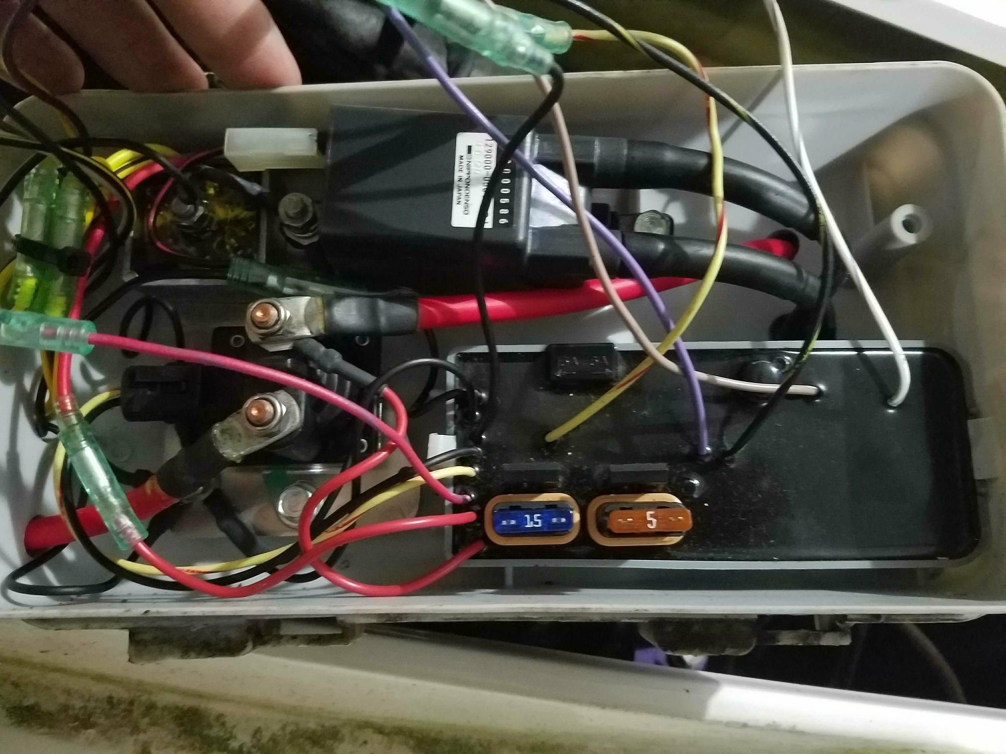

Could only crank it by hand. oil bubbled up from the carb manifold but not much. Don't know why the start button won't crank it. The ski beeps twice when I put the key on but no action from the start button now Seems like this ski is going to be a bigger challenge.

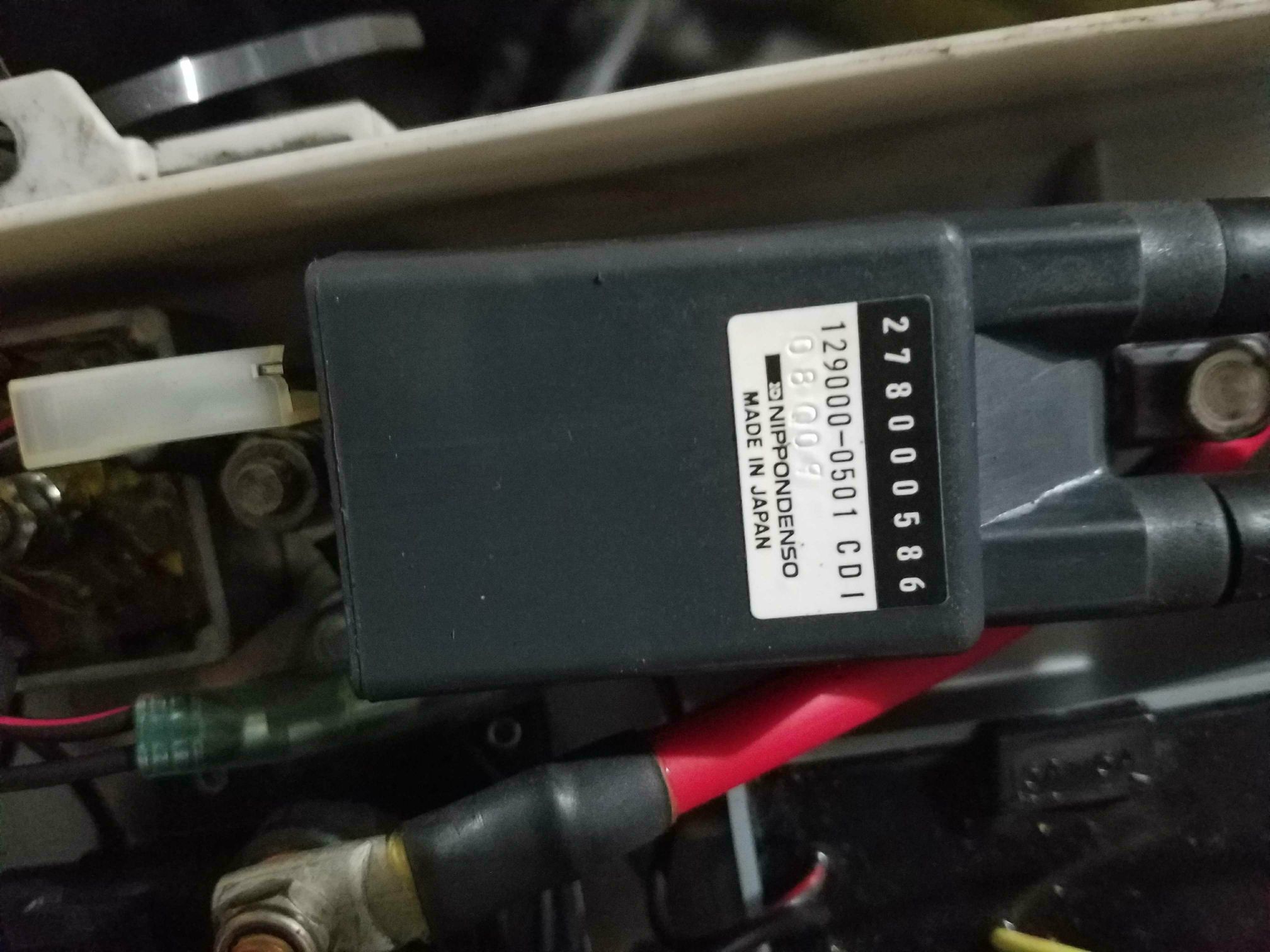

So electrical problems maybe. When I had the guy program the.new Atlantis key, the behavior was such that the guy thought it might be an aftermarket mpem. Ski would time out when trying to program it, couldn't access some settings, or program it with my name, and biggest clue of all, it said the ski , a 96, only had 69 hours on it. He got the key programmed, but suggested I might have so.e time out issues, I'm wondering if that's why it won't turn over when I try and start it. My other thoughts is it could be the post (doesn't always beep when I put the key on) or bad start button.
Any ideas on where to start or whet to check here?
Pics, let me know if there's any other angles or things I should take a pic of to give a better idea of what's going on
