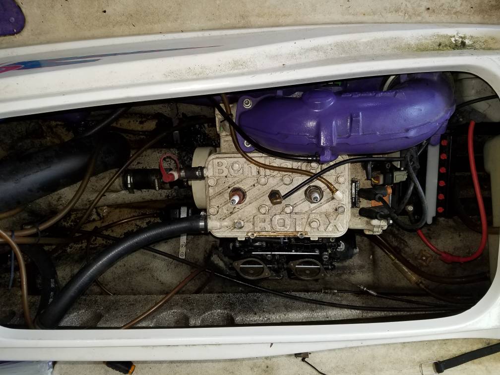

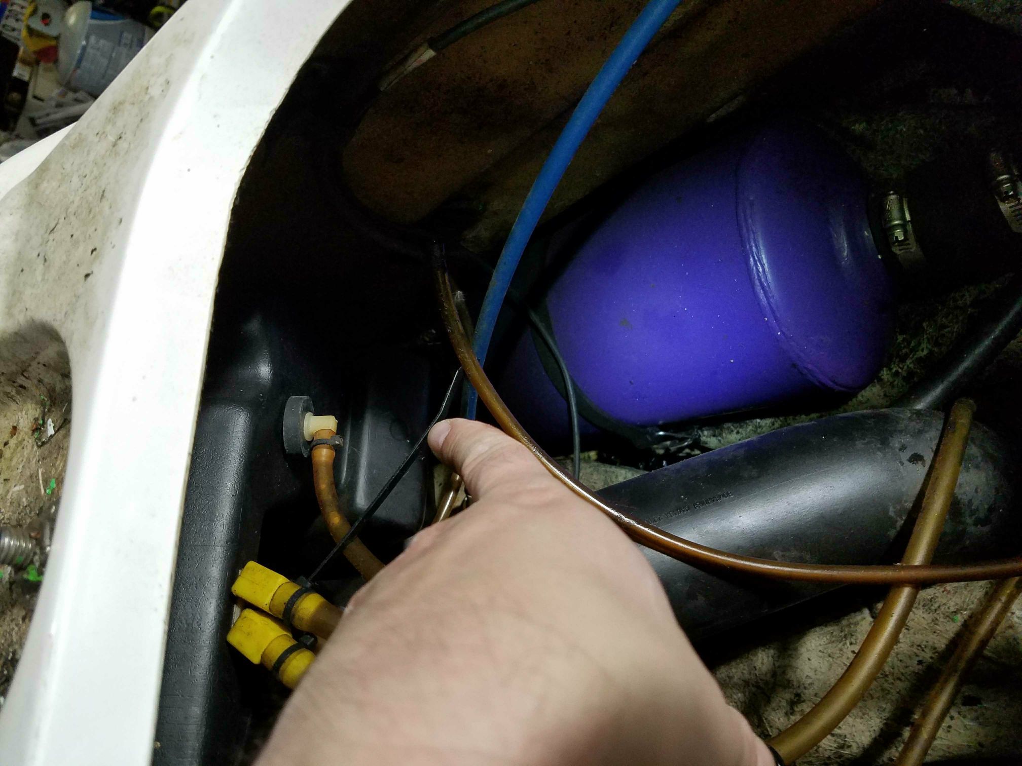

Sorry, first time using Tapatalk. In the first picture that 1 fitting coming off of the oil tank wasn't to anything, is that correct. In the second picture what is that fitting that I'm pointing to. In the third picture that is the inlet for the gas tank, you can see it's broken or cut. Any suggestions on best ways to fix that.

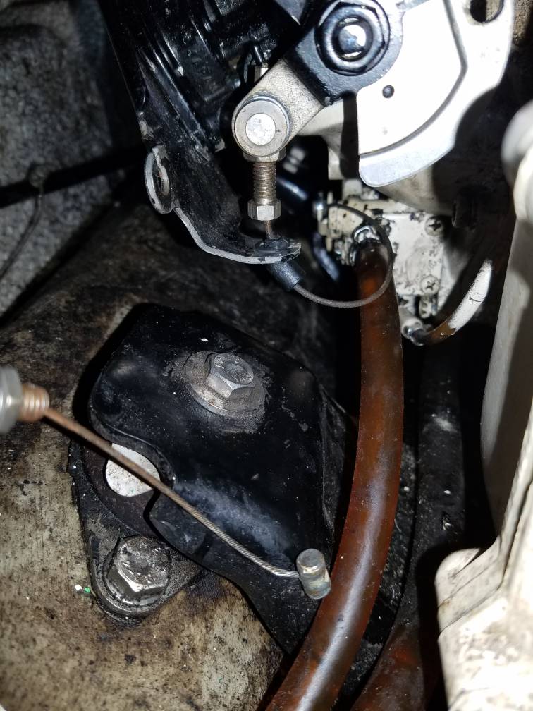

Sorry forgot to ask the question on this pic, the cable coming off the carburetor that goes to the manifold, and have it connected but the connection on the manifold has no spring, no return to it, that does not seem right. Am I missing something, I want to make sure before I get this air intake all back together

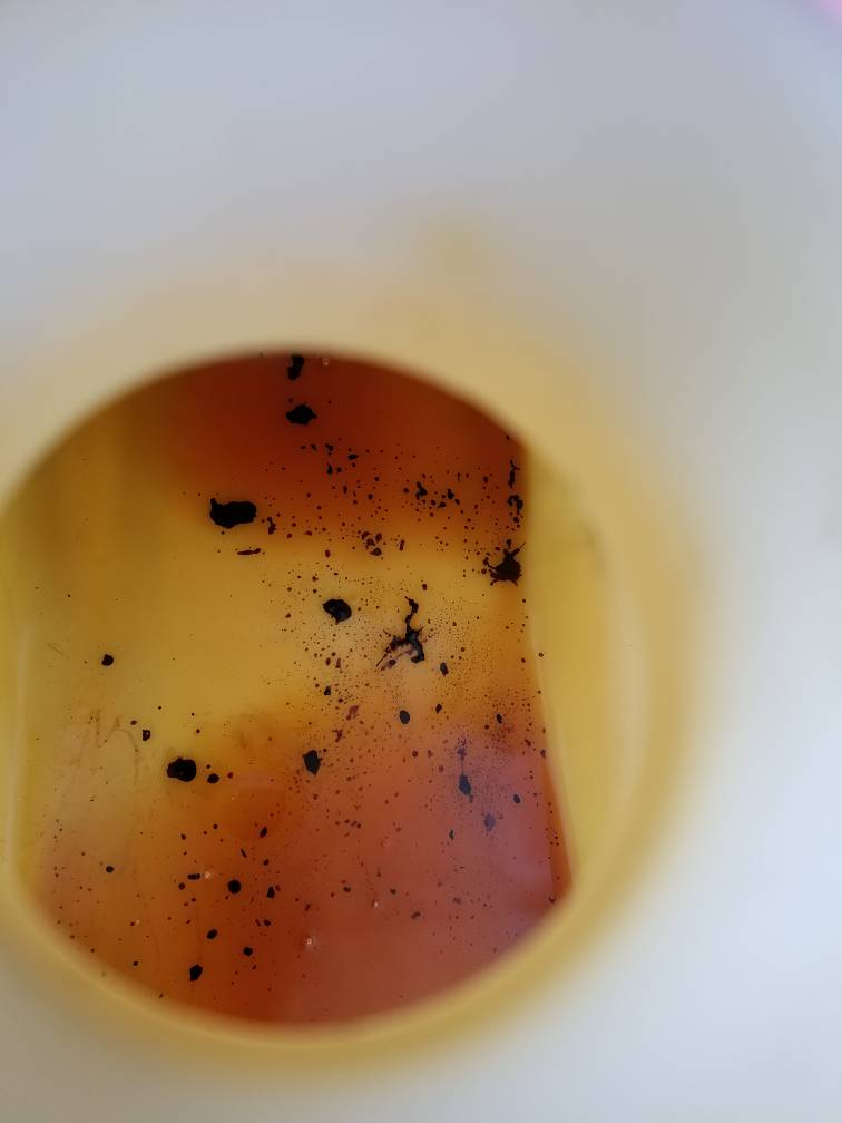

One more question, this is the inside of the gas tank. I was going to clean it out with some paint thinner or acetone, what do you think that crud is in the bottom?
You need a new oil pump if it doesn't return. That is what the cable on your carb goes to.
The other cable that isn't connected is either the throttle or choke.

The stuff in the tank is typical and can be cleaned out.
Hah, so I was feeding to cable over the top of the assembly instead of underneath, when does underneath, it springs back just fine.
So when I thought the oil pump was bad, I took the inlet line off. I put it back on when I realized the pump was fine, and have thus learned that I need to bleed the lines. Do I need to remove the carb (again?, ugh) to get to the bleed screw?

I can't find what this hoes that I'm pointing at goes to in my manual or online. Can anybody help me with this?

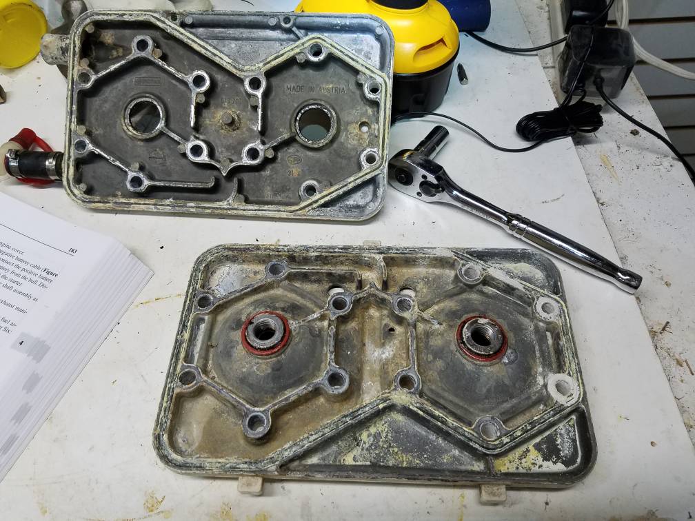

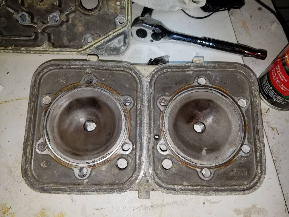

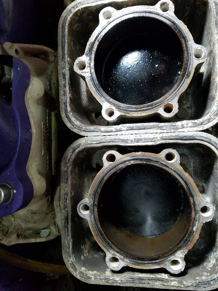

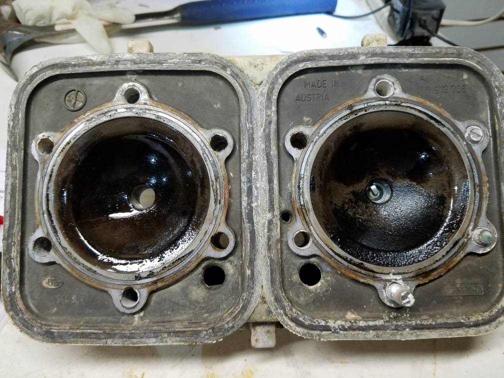

So, I took the head off the engine. Here's some before and after pics. Everything looks good to me, and untrained eye though. I can still see some cross hatching on the Piston cylinders, I think that's good. Should I replace gaskets while it's open.
Think that is a line for the battery when they did not use agm sealed batteries and needed to be vented
Trace it forward it ends in a hull vent. Looks like like clear tubing. Goes back as far as the battery.
