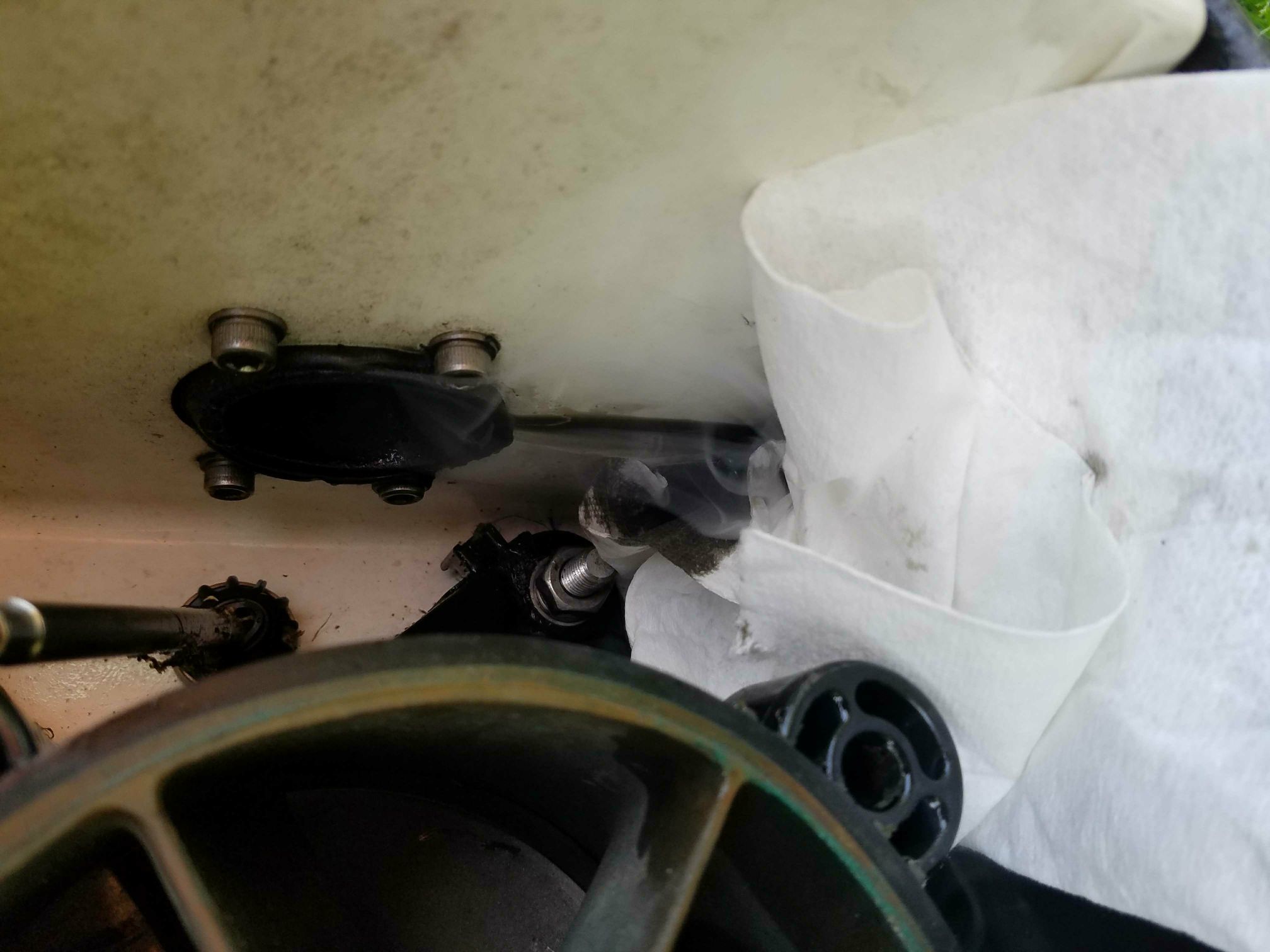

With a good tank I was able to get the ski to start. It starts immediately now and the throttle responds nicely. Problem now is the back end is spitting out a lot of oil. I had refilled the jet pump oil before getting it started. Haven't researched the problem yet, but wanted to post to get ideas.
Not completely sure yet. I was alone, and it was dark. The venturi is off. I think it's coming from exhaust, there is no oil from the cone or inside by the impeller, but it is oily in the exhaust outlet, and the oil is being spit out, cuz there are droplets splash all around the impeller housing. I'm going to check it tonight with a second person so I can get a better look while they start the ski. The first couple times it ran it blew out A LOT of smoke the last couple of times the smoking was less pronounced. I didn't have it hooked to the hose, so I didn't leave it running, and only started it ~3 times for ~5 seconds each, with time in between to cool down.

Oil is definitely coming from the exhaust
Hooked the hose up to let it run a little longer than 5 sec. Didn't have a good hose clamp. I took video, so you can hear the impeller. There's some clanging sound that doesn't seem right. What's the best way to post video here?

On the oil in the exhaust, is it possible that there was crud/oil sitting in the exhaust from the years it was sitting that got washed out when I hooked it up to the hose? After running it a little while the water coming out started to run clear.
If not, does anyone have any ideas on what to look at? I've tried searching for oil in exhaust on the forums with no luck.
If it has been sitting it likely just blew out some oil from the motor. I would not worry about it. These always have some oil around the exhaust area (they do burn oil so it is there in the system). And they are two strokes, so they will always smoke. But they should not create a cloud while you are riding once they are warmed up. Just ride the beast and have a great time! BTW, I restored 2 skis before I had ever sat on one. It is a great feeling when you get to ride it for the first time. I was way more nervous launching then riding. Just hit a nice quiet ramp when no one is around and take your time.
