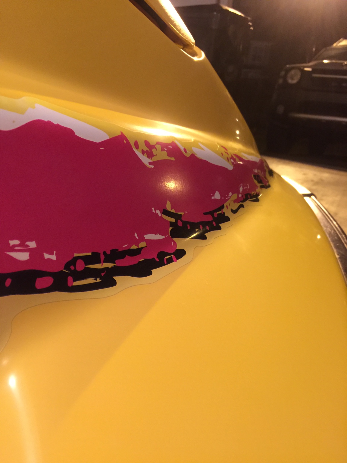

[MENTION=59515]suke[/MENTION] what drill attachment did you use to get your graphics off? Adam you need to check this thing out, it made short work of the decals. I used a heat gun and no chemicals and it took for fuggin ever!
Aircraft remover from wally world works great for me. Eat away anything
Sent from my SCH-I545 using Tapatalk
Since I can't link amazon I used one of these: 3M Stripe Off Wheel 07498, 3/8" Mandrel, 4" Diameter x 5/8" Width, Beige (Pack of 1).
I ripped off all the decals in less than 20 minutes. I'm talking ALL the decals( top, bottom, coast guard decal, other stickers PO put on, etc).
It did leave SOME gumminess behind that just wiped off with some acetone and an old tshirt. Total spotless took me less than 30 mins.

Are you going to cut and polish around the decals? I am in a similar situation where the decals don't look too bad but I really want to clean her up while she is here at home. Decal replacements are kinda of pricey all things considered so looking at my options to clean it up around the decals without it becoming too tedious.
^ jk hahahaha
Yea I have my decals taped off and I'm working on the hull now. The yellow isn't bad the pink is putting up a fight
