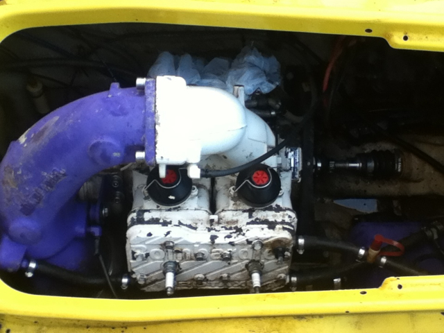

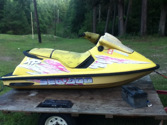

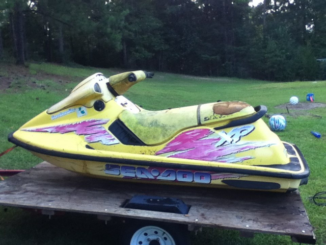

Just bought a 1996 xp and 96 spx for $150. Spx motor is toast so I am ebaying it out the xp has no dess key.. The air box was left off of it and the carbs exposed. I can make it turn over with jumpers to the starter and the oil I am spraying in the cylinders is coming back out very rust colored. Is it "worth" buying and having programmed a key... Just to see if I can make it run? An sell it. Trying to build $ to fix a seadoo challenger. Thanks :)

Dang that's a turd. You can get a compression reading without a key. Do that first to find out if the engine is toast or not
Won't the oil I sprayed into the holes give it an incorrect reading? How do I burn it off?

Thanks for the information! I just rolled the motor over to clear the cylinders of oil... Could get it to quite pumping at least a little oil out... Is that being injected? It seems to be. Did a compression check and back had 178psi and front 170psi. Isn't that a little high? As far as how much my time is worth... This is more like a labor of love, I really do enjoy making something that seems to be destined for the bone yard look and run well enough to turn heads once again :). .... Seems to be a time consuming weakness/habit of mine lol, and if I can turn a buck or two on it that would be awesome because unfortunatly none of these parts will fit on my challenger... It's got the merc. 240... Sitting in 3 boxes lol

What would be the best way to get an accurate reading? Spray some carb cleaner in to remove the oil? Or starting fluid?

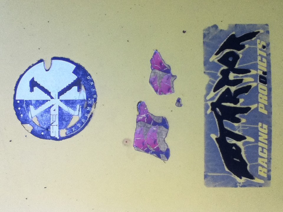

Any one know if these stickers might be representing some performance parts I might have? I am not familiar with any of them..... Any guesses?

I don't see anything in the engine bay that would indicate performance parts installed :(

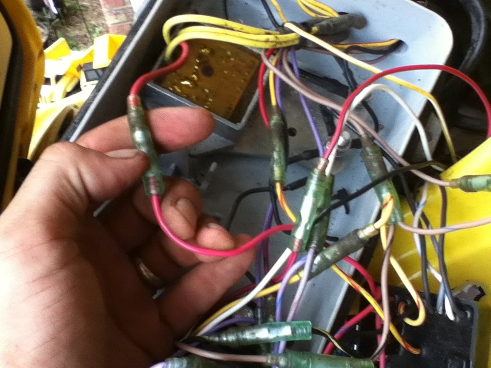

Got the mpem back from nick (thanks for the help!) and realized I had done something stupid, I yanked the mpem when it was night, thinking all the wires were color coded, and when I hooked em up for the 1st time today hoping for a beep beep I got..... Silence so I had a question for someone that has a 96 xp mpem to look at....

is this hooked right? It is a red bigger gauge wire on top and a little smaller pinker on bottom
