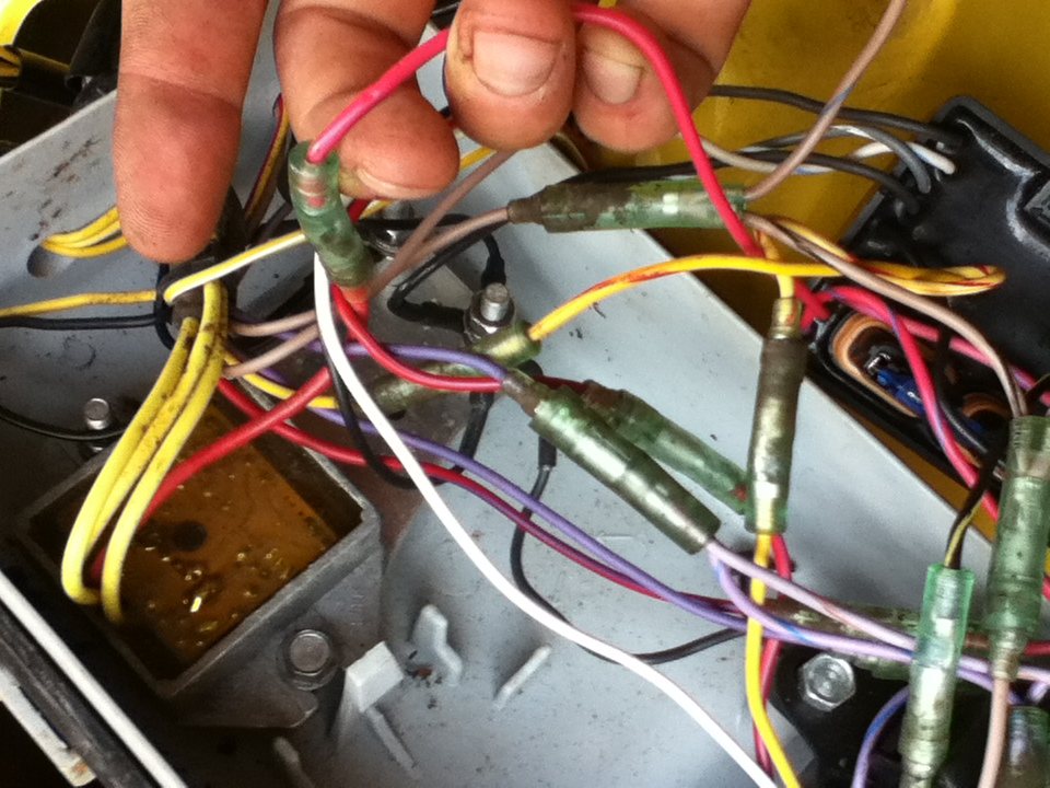

these yellow wires are both red stripped coming from the mpem... Couldn't figure which one was out bound and which should be going to that other black thing....( a relay maybe?)
Sent from my iPod touch using Tapatalk

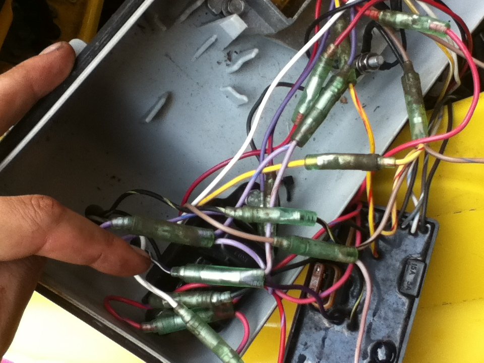

these purple wires also didn't match....the outbound one is deep purple with a white stripe and mpem just deep purple
Any help or pics would be greatly appreciate... Just want to make sure that I didn't hookup the mpem incorrectly b4 I stArt trying to find the problem elsewhere

Not beeping doesn't really tell you much. Those beepers are so flaky you can't count on them for anything. They'll work one minute, then not, then 10 minutes later they're working again.
That's true, my beeper works sometimes on my 96. I don't think my 95 has a beeper, it's never made a noise.
pull the wire off the sensor on the head and ground it to the base of one of the spark plugs. beeper should scream and the overheat warning light should come on.
