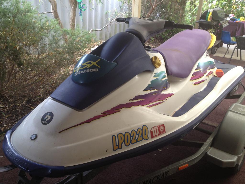

Anyway here are the gsx pics, this is a 800 right?
But she wants $1500 for this... bahhhh!!!!!!
Salt use, grey fuel lines, sun fade, blah!!
I missed the aftermarket sponsons. I like that
