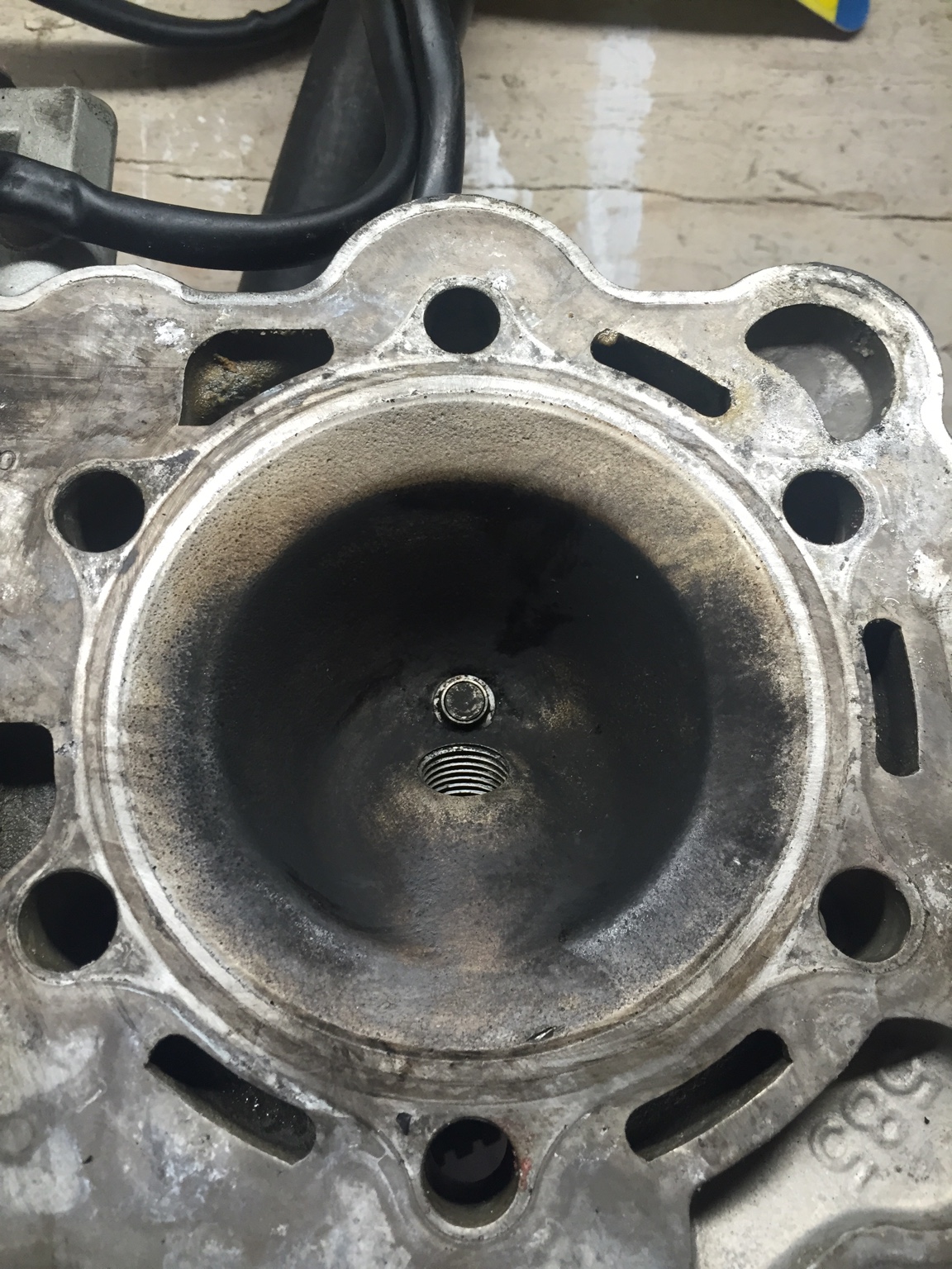

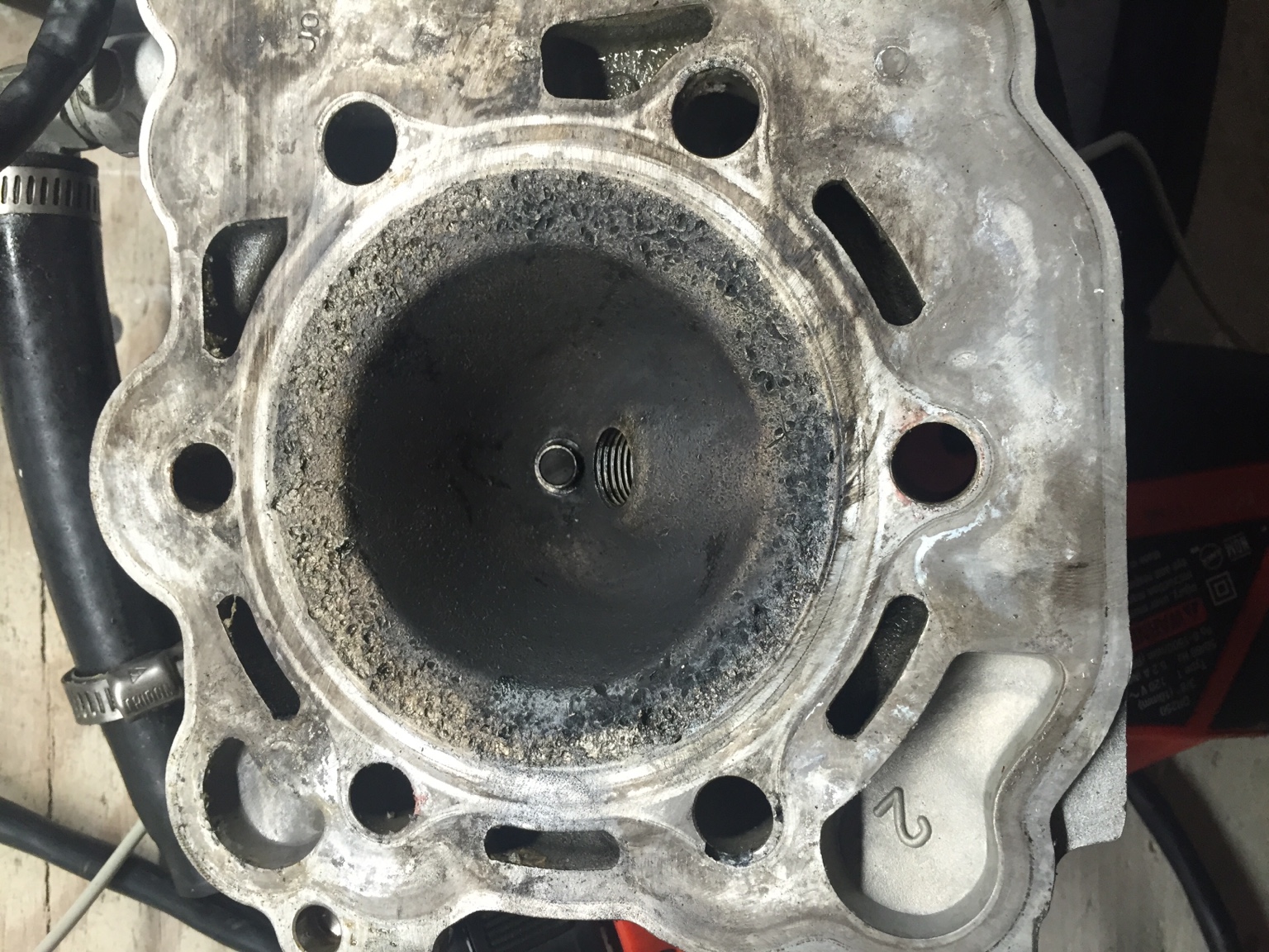

As the title says. Would you bolt this back on? Doing Pistons rings and bore.
Nope, I wouldn't run that. Especially if it's a flip, you don't want the next guy coming back to you.
Yes, I would use it as long as it's flat and sealing surfaces are good which they normally are. All you need to do is knock off the high spots with a dremel and remove any pieces such as embedded ring pieces which doesn't even look like you have any. Do not remove material as this will lower compression so do not sand or smooth out. I've run heads much worse than that and they have always been fine and will last just as long as a new head with identical compression to the other side.
In a combustion chamber and air/fuel travel in general, you don't need smooth surfaces. In fact, rougher surfaces help to atomize air/fuel mixture better.
Nope, you shouldn't not run that head. I have a good used one for $50 plus shipping.
Chester
Assuming you have big stones, you could give it a "sidewalk shave" and slap it back on would probably be okay. That's not the right way to do it of course, and it's not gonna be yours so you probably want to avoid doing that for the little bit of money it'll cost to put something undamaged on there.
IMO
I'm trying to get this back together ASAP does anyone want to sell me a used head?
[MENTION=13190]Chester[/MENTION] wants to sell you one. I know you said his mail box is full so the @ sign in front of his name will get him here.
Perfect I found him and shot him a pm. Thanks for the help guys. Our of curiosity for those that said don't run it can i ask why?
I wouldn't run it just in case there is a fragment you can't see that becomes dislodged and fall back into the cylinder. The other reason, I'd be afraid that you'd get a hot spot and cause detonation (long shot). For me the reward is not worth the risk.
