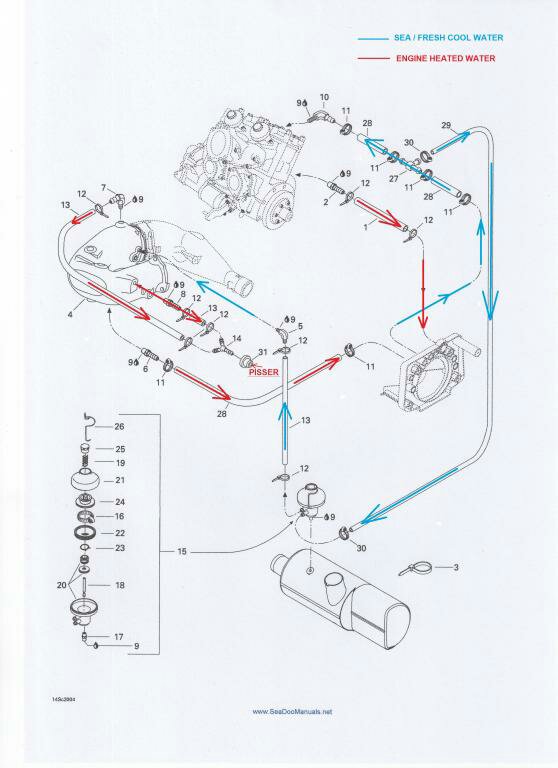

Does any one have a hose diagram. I'm helping a friend with a different ski, Di xp put his motor back in and it's a mess and I don't know where a ton of the hoses go.
