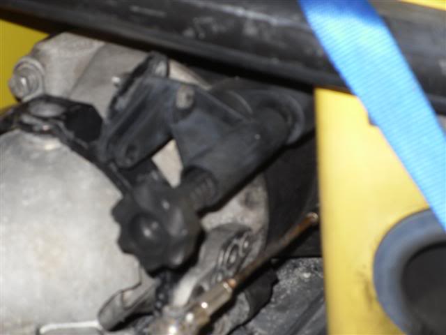

top view of screw knob
side view from right
fuzzy closeup.
essentially that little dial is a screw that moves the nozzle up/down, its actually a very simple little mechanical device :)

Spim, mine looks a little different, I never knew there were variations on the bracket. You are rockin the R&D also, I guess you didn't crack yours.
