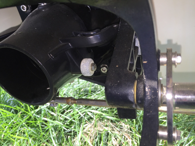

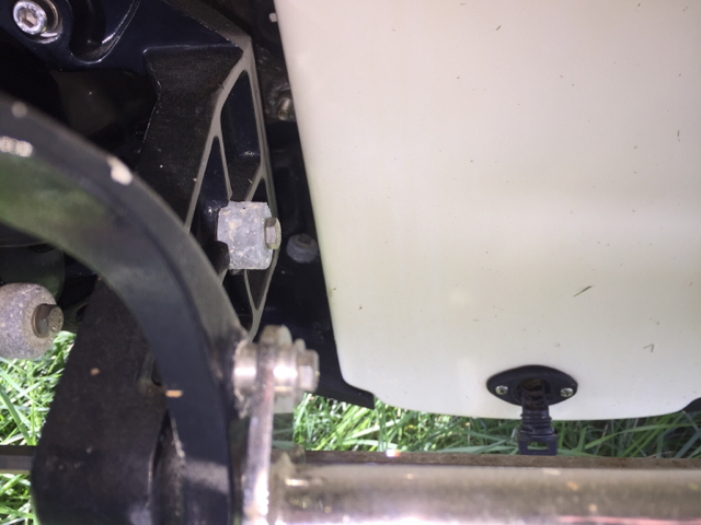

I need to double check how many are on ours. From what I can see I should have (twin engines):
1 on heat exchanger
1 on reverse bucket
1 on steering nozzle
1 on pump/impeller housing
1 on reverse gate support
5 per motor. 10 total.
Live and learn. I checked the schematics, and I can't find one on the reverse bucket. Only shows one in jetpump, one near carbon seal, one on heat exchanger. So six total. But, there has to be one back there...

There are two zincs, one on the reverse gate support and one on the reverse bucket. Rivamotorsports.com Ref. No. 5, Part No. 271001487 Description: Anode zinc, Price: 10.99 ea. There is also one on the ride plate, steering nozzle, pump impeller housing and heat exchanger. A total of six or seven zincs, all with the same part number.

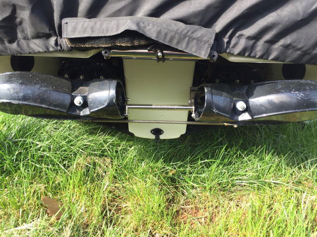

They are hard to miss.

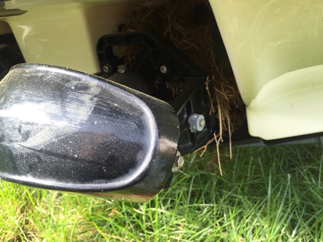

Now, I just have to figure out what to do with the nest above my starboard jet pump that I discovered when I went to take these photos.
