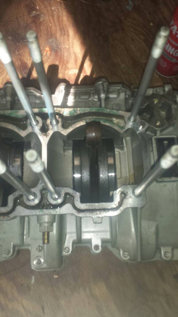

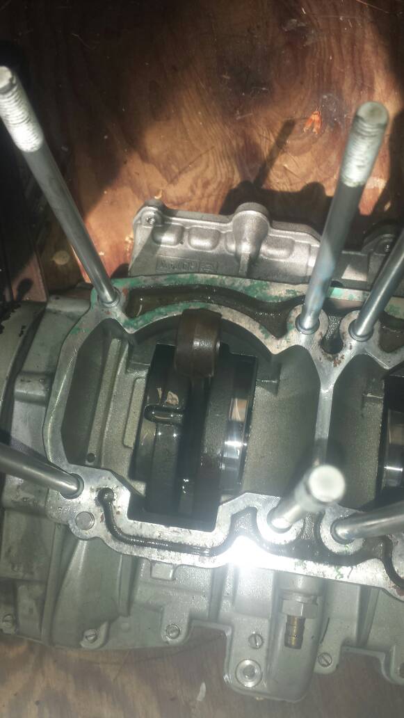

The one in there looks brand new but it sounds like there's some slack in one of the bearings
At this point who knows what the previous pos did to this ski the water tray under the motor was apparently deleted the bottom end has been gone into since all the bolts paint is chipped away it had those garbage wsm pistons in it. There was a lot of vibration at idle that's what broke the twin pipes

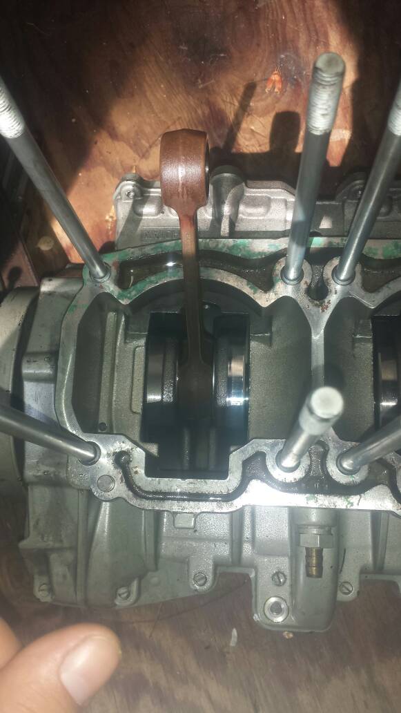

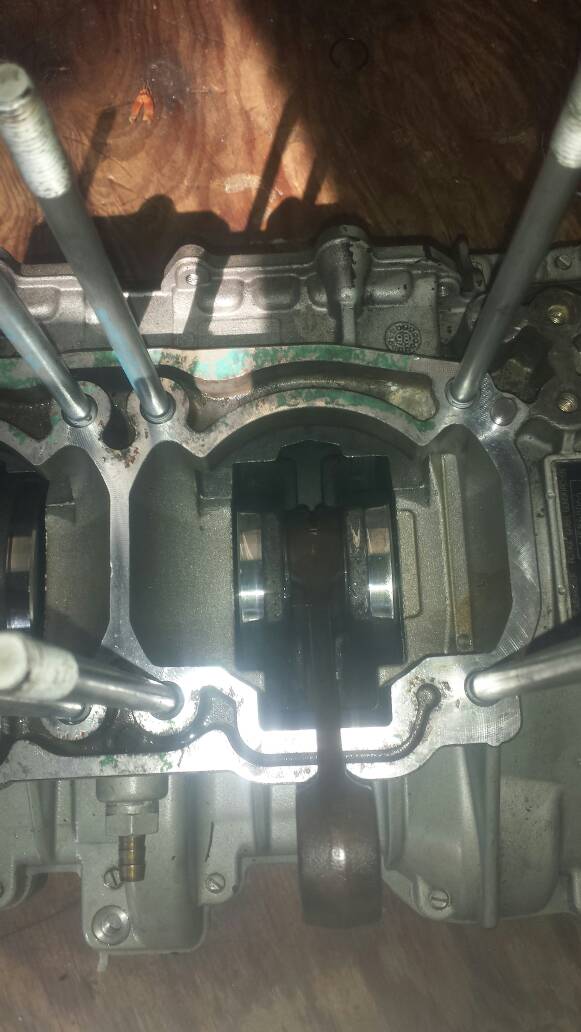

How much play should there be on the rods front to back feels like about 1/16 on each one of these.

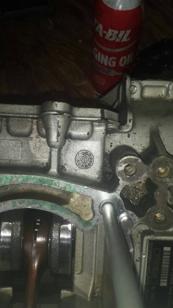

If you want to verify those cases, call your dealer and give them your HIN number. From that they can tell you the engine SN, which is on the tag, if the number they give you doesn't match the tag on there then those are not the original cases.
Actually if you look at the holes where the case cooler goes...if they are not threaded, along with the 98 casting mark tells you someone had a disaster with the original cases. All 3 of the RXXs I parted had chunks of case in the bottom of the hull.
