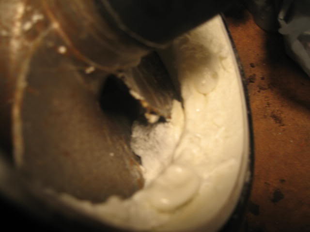

Does it look like this?

Well, it doesn't look nearly as bad as that melted ring, but it was still causing some baaaad cavitationP1040458.JPGP1040457.JPG
Does that tell any stories to anyone?
