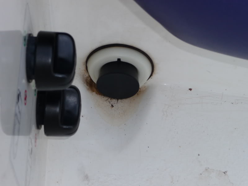

Here is a picture of it mounted. Sorry, only 5 am here, and still dark outside, and picture turned out crappy. But you can get the gist of it...
