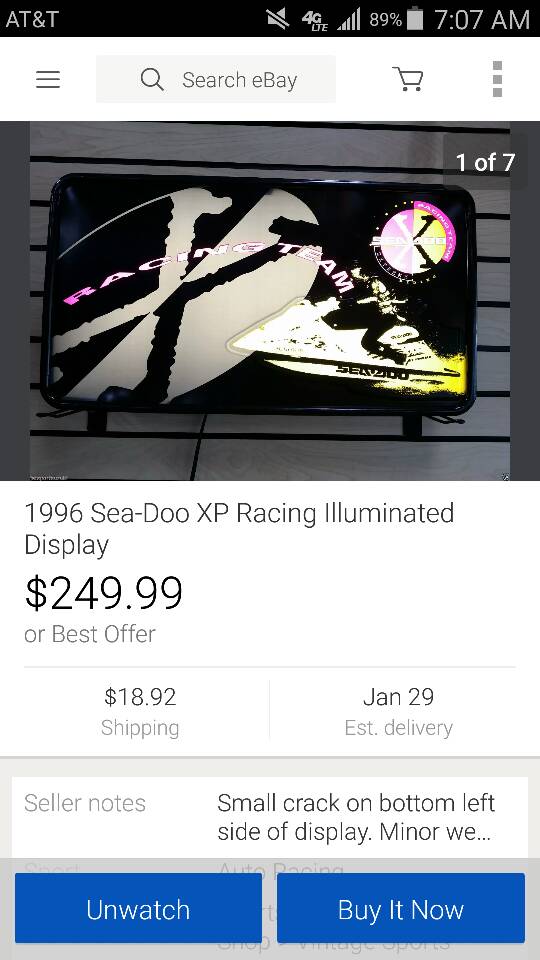

$250 seems a bit high but still cool. Accepting offers though...
My buddy trashed an old Speedster, but not before he cut out the huge SEADOO logo out of the side. I plan to turn that into a cool sign to hang up in the garage someday.

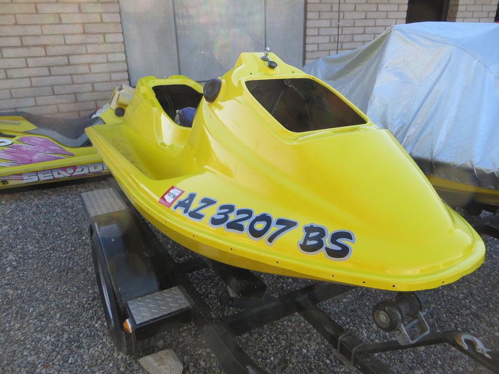

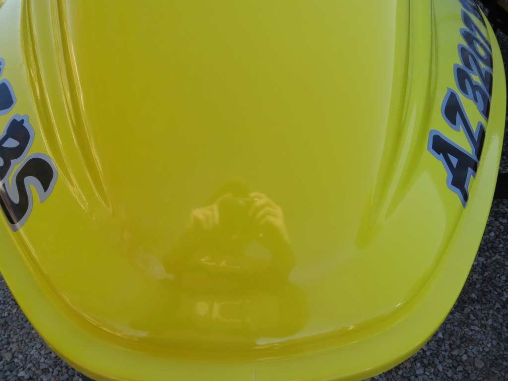

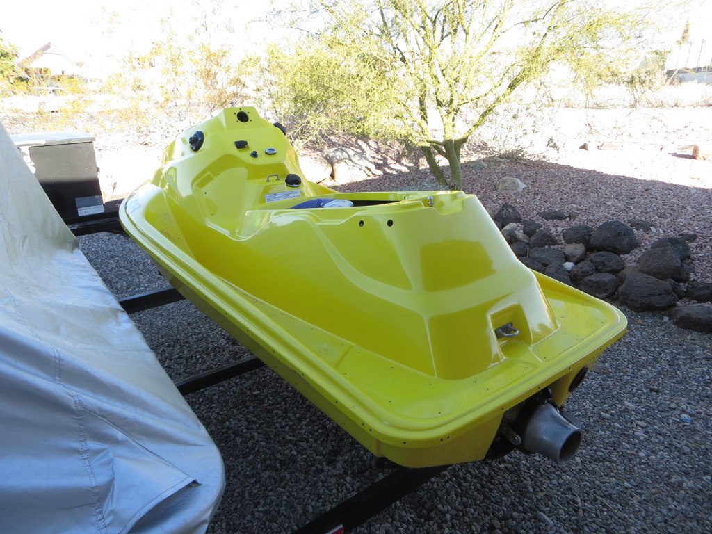

I buffed my hull using the JSG method as described in his thread on buffing nasty hulls. Mine wasn't all that bad to begin with but it still made a huge difference.

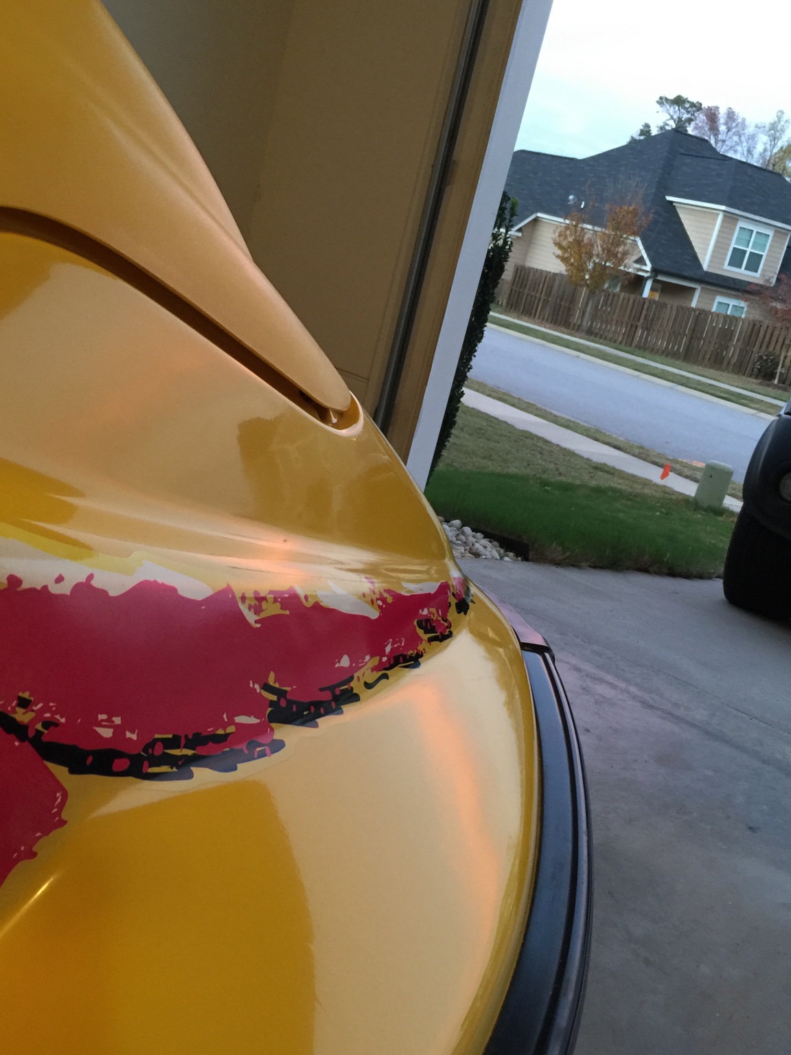

This was the worst area it was chalky yellow on the top of the nose.
Big thumbs up to JSG for the tutorial. I used wool pads for heavy and medium cut and foam for fine cut and synthetic sealant, then hand waxed it.

Very nice job! JSG's tutorial is pretty awesome

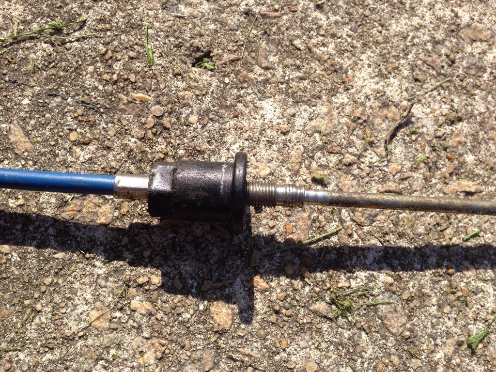

I have an issue with my steering now, I installed one of my UMI systems and the stem was tilted to the right with the nozzle straight. So I read you can adjust the steering cable at the end. I adjusted it all the way in at the nozzle and still was only about 30% better. Found another adjustment at the front end and adjusted that all the way in and its close but the steering stem still a little tilted to the right when nozzle is straight out the back (or steering nozzle to the left with stem straight). WTF do I do now I cant possibly adjust the ends in any more they are bottomed out, unless I were to remove a jamb nut from one end to get that couple extra turns in.
Anyone have this issue? I checked the steering cable on the parts ski I took the UMI off of and it has threads visible for adjustment on both ends but my cable ends are bottomed out and still not adjusted correctly.
The plate that backs up the neck has a black plastic piece and an aluminum piece. They sammich an adjusting collar.
Wow, I didnt know that was adjustable. Feel a bit dumb now, Im done for the day messing with the ski but I will play with that tomorrow. Got the stem system installed and single gauge hood for today lol. Shes looking beautiful already.
