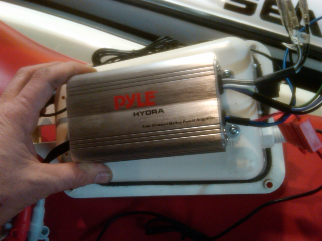

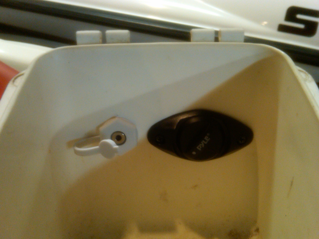

So my amp came in over the weekend and I started the install of it as I wait for my speakers. I removed the center storage and mounted it on the bottom and placed the volume and 3.5 mm plug on the inside of the compartment. It all fits in nicely and will hold the iPod in it's otter box. I bought the Pyle marine amp kit just incase the 2 Polk Audio 6.5" speakers aren't enough. It can run 4 speakers while the Poly planer kit was just 2.
What do you all think so far?
